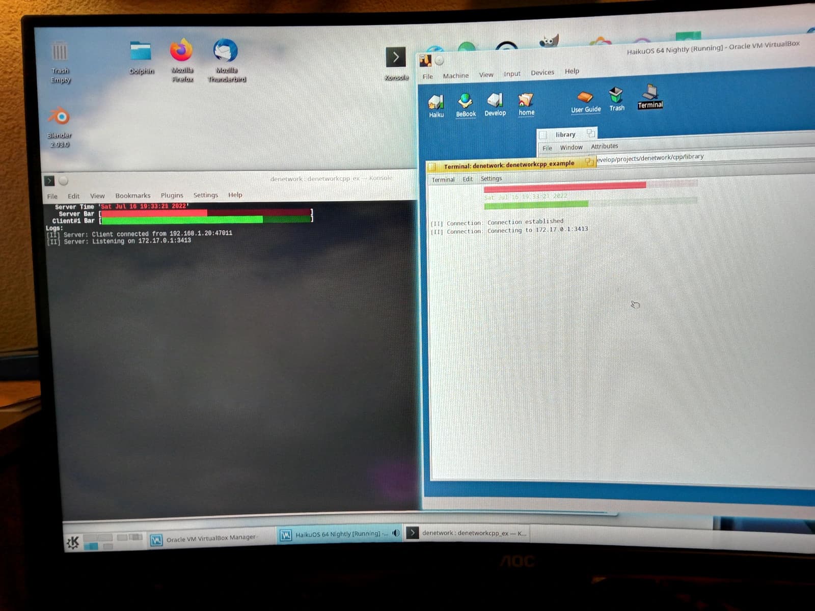

DENetwork Libraries now builds on Haiku. I’ve updated the release on github with the prebuild static library: Release Drag[en]gine Networking Release 1.0.1 · LordOfDragons/denetwork · GitHub

DENetwork Libraries now has IPv6 also on Haiku but I’m not sure if Haiku actually has IPv6. In a full listing I get “::1” but no IPv6 for the LAN interface. Could be VirtualBox, not sure. But technically it should work.
::1 is the ipv6 loopback adress, we have an ipv6 stack but no autoconfiguration, you can use ipv6 on localhost but it should work in your LAN if you manage to configre the right adress
Updated the Drag[en]gine with IPv6 support too. The 1.14 will contain it or the nightly of course. Time to go back to more important things to do :smiley:
