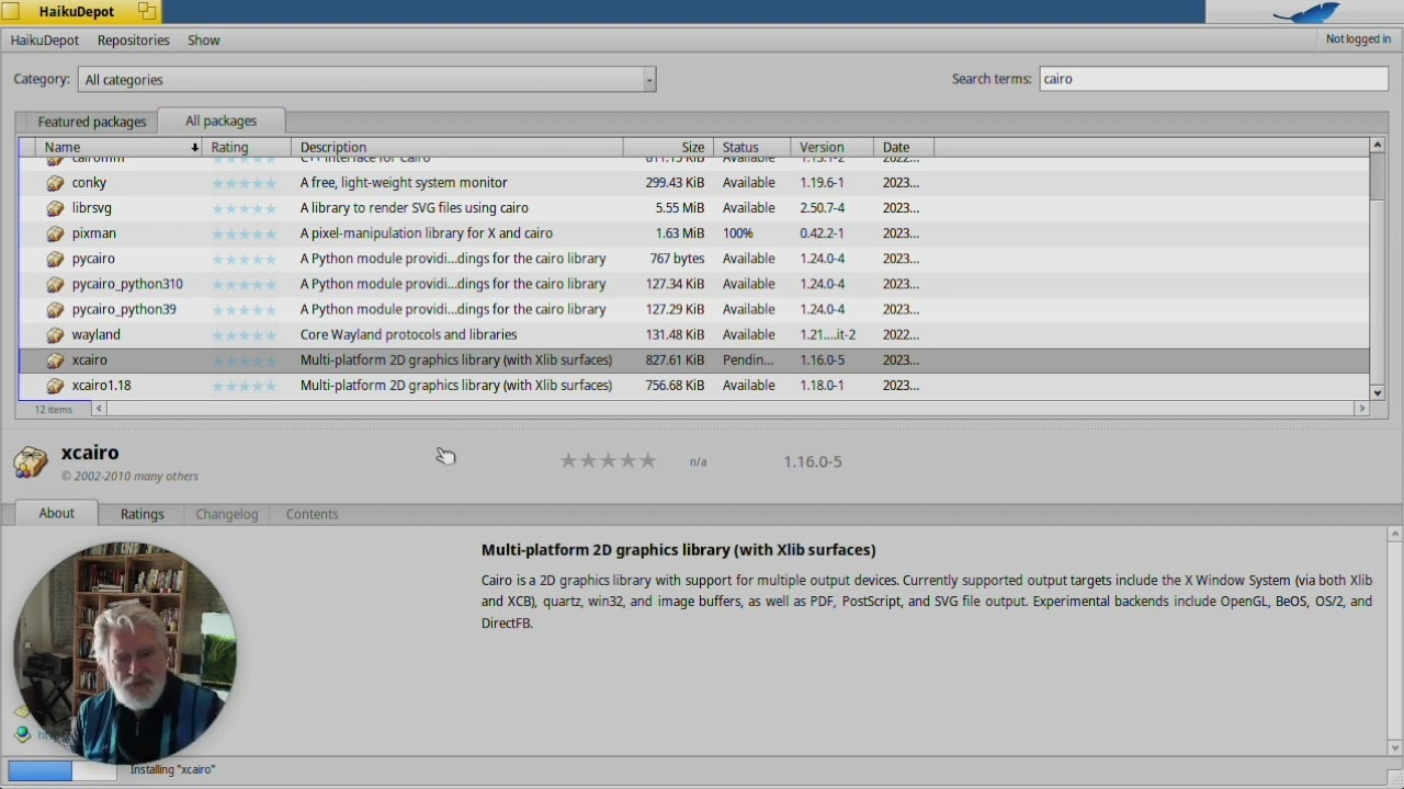

Install xcairo. All sorts of installation problems disappear when you do that. If some programs are uninstalled in the process, you can always reinstall them.
If deinstalling cairo had any consequences, they would be also listed in the dialog.
In this case, the dialog should probably hint with ‘recommended’ that it’s ok to deinstall.

xcairo should be not needed in first place. Haiku GTK 3 port do not use X11.
Right - I spent time to watch your informal video, dear Michel, and then I checked the installed packages : is there any cairo package installed?
as actually still had not developed package manager command
pkgman list-installed
and
pkgman listinstalled-by-category <category>
I just issued list command for any cairo Haiku package in (activated) packages directory :
~> ls -l /boot/system/packages/*cairo*
-rw-r--r-- 1 user root 734903 ápr.    7 01:48 /boot/system/packages/cairo1.18-1.18.0-1-x86_64.hpkg
-rw-r--r-- 1 user root 847473 ápr.    7 01:48 /boot/system/packages/xcairo-1.16.0-5-x86_64.hpkg
This way I can see: yes, a newer one cairo was installed, instead of above reported version, but also some app or library ‘installed’ xcairo package as well, but that also higher subversion than the deinstalled one.
I do not argue on it related GTK - I just seen some basic X.org packages, but when I attempted to install them from curiosity
I got conflicting versions among two them, as one of them expected higher one libx11 that is actually available in the repo … stated which is not the expected object in the one available.
At the same time also one warning as then xlibe should be deinstalled. So naturally I skipped the whole install.
