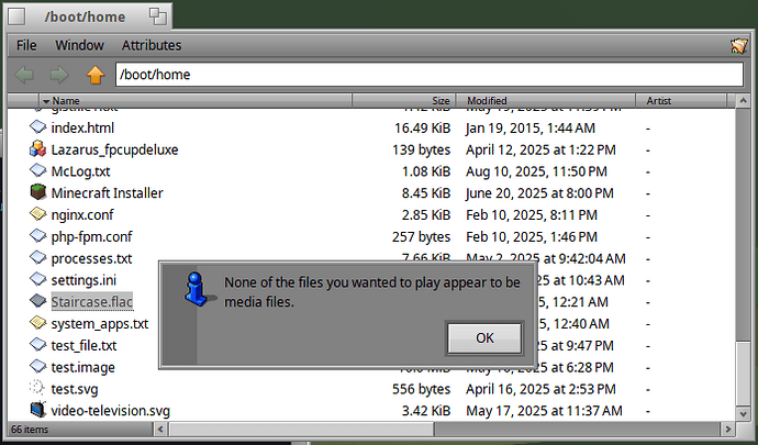

I’m trying to open a symbolic link where the source is an audio file located on my NAS (non BFS).
I have the below error message:
Same when opening the file with the Tracker:
However launching the command below is working fine, meaning the link is valid : MediaPlayer /boot/home/Staircase.flac
I’m trying to identify which part of the system consider the file as “invalid” making it impossible to open via MediaPlayer (except with the above command). Any idea ?

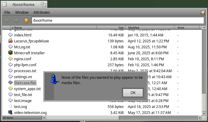

Ok I thought it was an issue with the Tracker, but I think you are right : this limitation seems to come from MediaPlayer (to confirm)
Drag and drop of an audio symlink not on a BFS : MediaPlayer didn’t recognize it

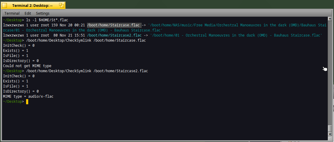

Finally I have identified the problem.
The program for this test :
#include <Entry.h>
#include <Path.h>
#include <NodeInfo.h>
#include <File.h>
#include <stdio.h>
int main(int argc, char** argv) {
    if (argc < 2) {
        printf("Usage: %s <symlink_path>\n", argv[0]);
        return 1;
    const char* path = argv[1];
    BEntry entry(path, true);  // traverse = true
    printf("InitCheck() = %d\n", entry.InitCheck());
    printf("Exists() = %d\n", entry.Exists());
    printf("IsFile() = %d\n", entry.IsFile());
    printf("IsDirectory() = %d\n", entry.IsDirectory());
    if (entry.IsFile()) {
        BFile file(&entry, B_READ_ONLY);
        BNodeInfo info(&file);
        char mime[B_MIME_TYPE_LENGTH];
        if (info.GetType(mime) == B_OK) {
            printf("MIME type = %s\n", mime);
        } else {
            printf("Could not get MIME type\n");
    return 0;
It means the BNodeInfo.GetType() is missing a “fallback” method when the original audio file is not on a BFS volume.

BNodeInfo.GetType returns the right thing: there is no type information for that file yet.
It’s up to the application to handle that case and use the MIME sniffer to try to identify the file in that case. Or maybe the filesystem can do some faking of it based on file extensions (we do this for FAT and NTFS for example, but not yet for NFS).

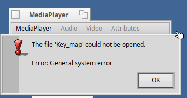

Ok removing the test “_IsMediaFile(mimeString)” resolves the issue :slight_smile:
And in case of a bad media file the below error is displayed:
