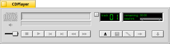

CDPlayer
Note: Maybe find a simple replacement or fix…

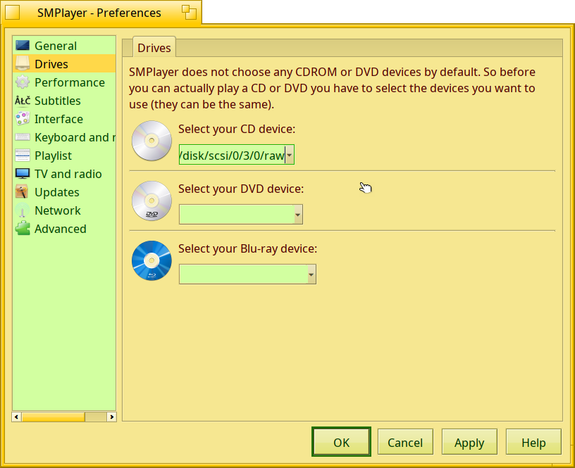

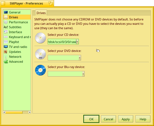

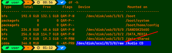

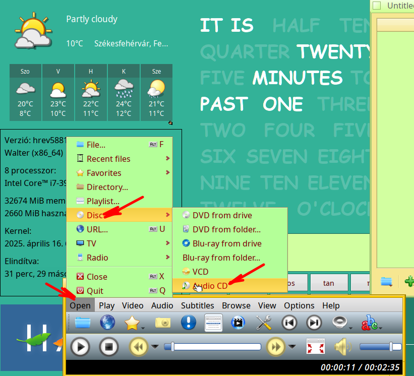

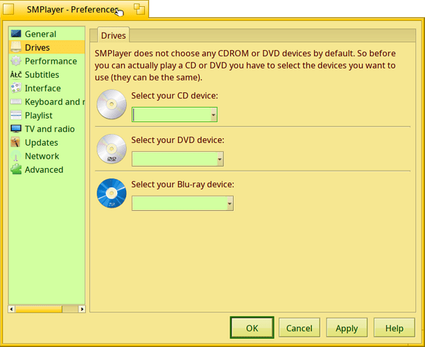

As I wrote earlier here on the forum, I found one app that can play files directly from the CDs :
it is SMPlayer.
You have to drag and drop the mounted music CD from the desktop onto the SMPlayer’s control or player window. .

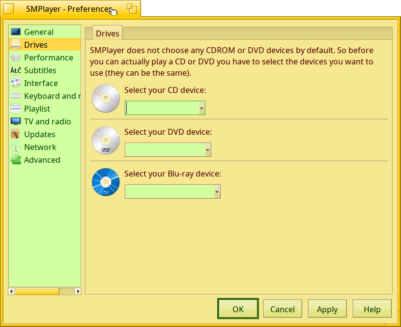

As I wrote it can play, but only this way - you launch SMPlayer, as Audio CDs do not exist as an object which can be assigned to a specific application program. Only open exists for right click, that just opens a Tracker window - showing tracks as vaw files in a folder, against staring to play the tracks from the disc.
If you try the vaw files with right click on the roll down menu, then …
that tries to play it with Mediaplayer - but that fails.
Even VLC fails - it does not play as on Win/Linux but does some conversion on files on Haiku, maybe load tracks one-by-one to memory or else place , but surely cannot play as it expected by its nature.
SMPlayer won’t stutter or require to copy the files to disk.
It is the one and only - direct CD player -program on Haiku actually … that can do direct play without a hassle - but you must load the CD drag ‘n’ drop.
It won’t open the audio CD from the program - it had not adapted to Haiku …

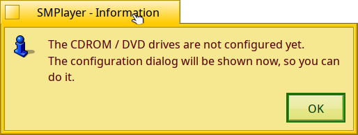

# First
# Second
# Third
# Fourth
# Fifth
# Sixth
Clicking OK - again !..
# Seventh
So, here you are - in an endless loop ! … this can be avoided using drag ‘n’ drop the Audio CD icon from the Desktop.
