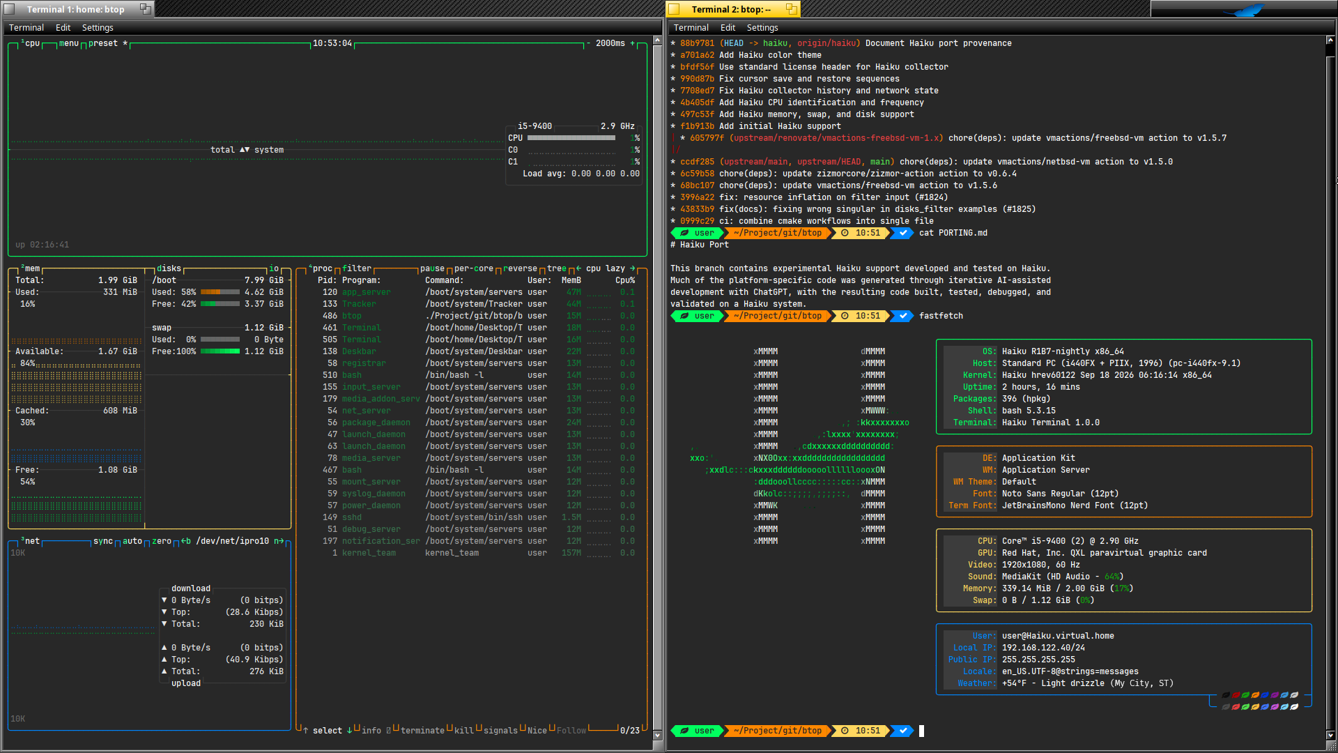

Been playing around with Btop on Haiku the past couple days.
Btop itself is almost 100% vibe coded in ChatGPT so not likely to see a port from me, but I rather liked how the Haiku theme came out (the only thing I did myself essentially). Btop shown in left terminal, earlier fastfetch theme in right.

Yeah, I wasn’t very clear. I made very few changes to Btop itself so I assume there wouldn’t be much issue porting it. What was done by ChatGPT on my end was to build the entire Haiku collector. There are a few things that don’t work like load avgs, cpu temps, and battery support. But that’s because I was building on a VM where temps and battery just aren’t available, and I’ve been unable to find a way to expose load avgs, and I didn’t think I should try to build anything I couldn’t test myself.

The git graph is just “git log --graph” (in my case “git log --oneline --decorate --graph --all --max-count=15” specifically).
The prompt is discussed in another post by me earlier in this thread but it’s just a matter having JetBrainsMono Nerd Font installed and set as the terminal font (other fonts may or may not work) and in your /boot/home/config/settings/profile file add:
PS1='\[\e[38;5;47m\]\[\e[0;48;5;47m\] \[\e[38;5;235;48;5;47m\] \[\e[0;48;5;47m\] \[\e[38;5;235;48;5;47m\]\u\[\e[0;48;5;47m\] \[\e[0;38;5;47m\]\[\e[38;5;235;48;5;208m\]\[\e[0;48;5;208m\] \[\e[38;5;235;48;5;208m\]\w\[\e[0;48;5;208m\] \[\e[0;38;5;208m\]\[\e[38;5;235;48;5;221m\]\[\e[0;48;5;221m\] \[\e[38;5;235;48;5;221m\] \[\e[0;48;5;221m\] \[\e[38;5;235;48;5;221m\]\A\[\e[0;48;5;221m\] \[\e[0;38;5;221m\]$(\
  if [[ $? -eq 0 ]]; then \
    echo "\[\e[38;5;235;48;5;33m\]\[\e[0;48;5;33m\]\[\e[1;97;48;5;33m\]  \[\e[0;48;5;33m\]\[\e[0;38;5;33m\]"; \
  else \
    echo "\[\e[38;5;235;48;5;196m\]\[\e[0;48;5;196m\]\[\e[1;97;48;5;196m\]  \[\e[0;48;5;196m\]\[\e[0;38;5;196m\]"; \
  fi \
)\[\e[0m\] '
