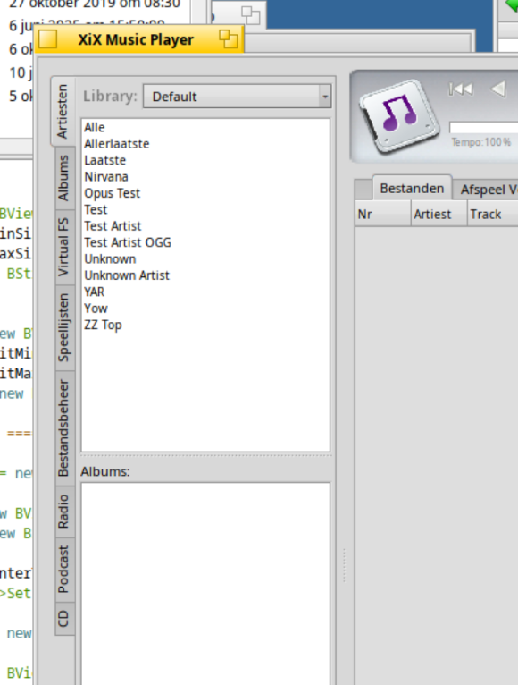

I would like to make (an effort to) XiXMusicPlayer from scratch using only Haiku API.
In Lazarus it was posible to place tabs where you want, but using the Haiku API I only see the possibility to have them on top.
Is it possible to have the tabs not on top?

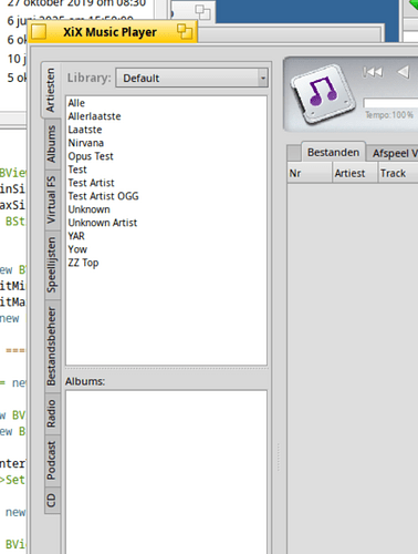

I don’t see it documented, but I knew I had seen it done before. Skimming the source (I mean I have not tested it), it seems you’d want to SetTabSide(BTabView::kLeftSide) on your BTabView..
Thanks @madmax , that did the trick.
Schermafdruk_20260425_200533

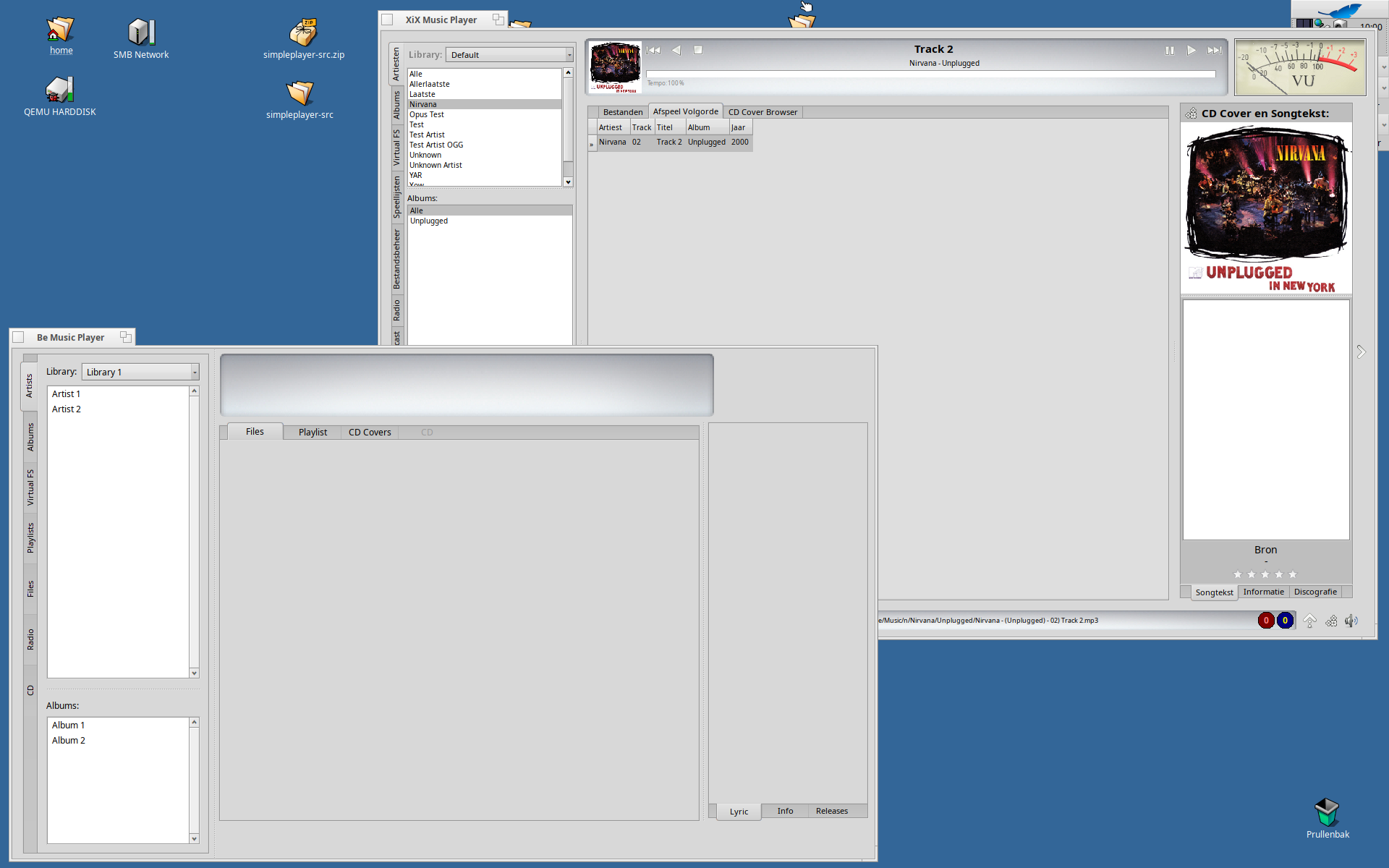

Side tabs are supported. The most prominent place they are implemented in Haiku is the PowerStatus/Battery Desklet. I even made side tabs work in BeControlLook if you’re into that kind of thing. You can look there to see how it was done.
