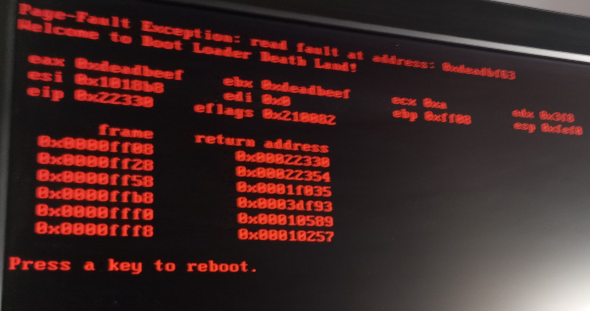

Why did not the installer do these actions automatically?(When booting using usb /boot is assigned to usb and active, i also formatted the disk to befs manually).Another strange thing is that if i remove the usb and try to insert it again and reboot i get boot loader death Land (this is reproducible at least for two different days)

Here i also arrive at a state that also the usb after a few restarts gives boot loader death land and i have to recreate it using another pc in order to try again
