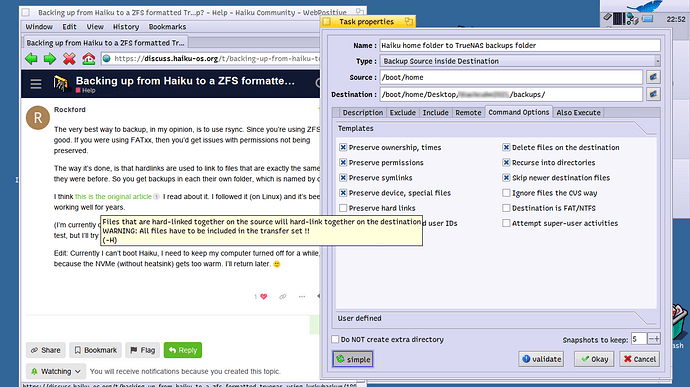

Backing up from Haiku to a ZFS formatted TrueNAS using LuckyBackup?
Thanks to a lot of help from my Haiku friends on this forum, I am now able to mount a large share from my TrueNAS Core network drive using nfs4.
So I’m wondering how best to use this as a destination drive for regular backups of data from my Haiku laptop.
I guess I need to find a simple way of zipping up People and audio files containing Haiku attribues before using LuckyBackup or rsync to make incremental backups to my TrueNAS once I’ve got it mounted to Haiku’s desktop? Is there a recommended way of automating as much of this as possible?

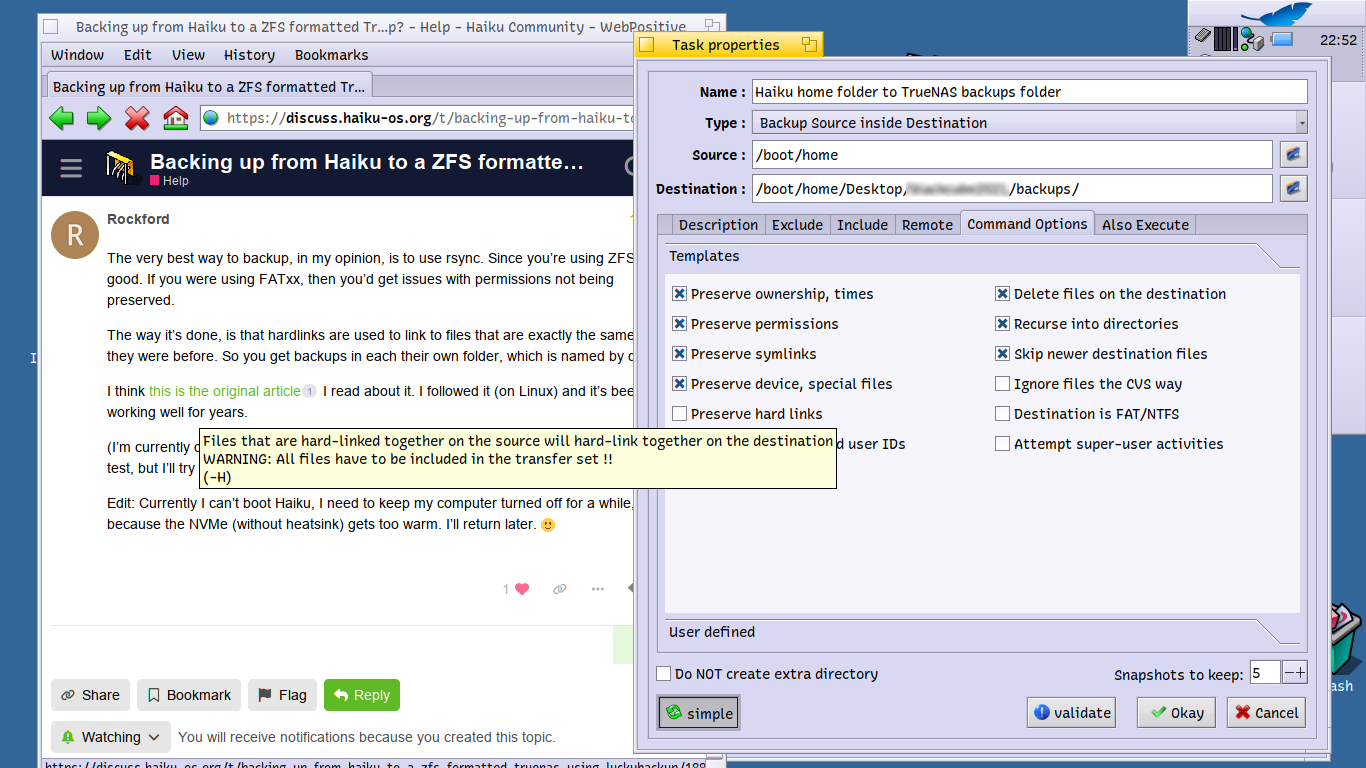

I’ll study it and then try to see if I might not be able to reproduce its methods using LuckyBackup (a GUI wrapper around rsync). There’s an option to “preserve hardlinks” there so it might actually work the way that the article explains.
I won’t be able to use cron to automate the process like I would with rsync, so after I get used to taking regular Haiku snapshots manually using LuckyBackup I might learn enough to start using rsync without the GUI…
you can try to add --xattrs in the Options > User Defined to see if it will succeed to somehow save attributes. I’m not sure the rsync binary on Haiku is able to support BFS attributes, though, so maybe it’s useless.

Thanks for the rsync script! I haven’t tried it out yet but I did make an initial backup using the rsync GUI wrapper, LuckyBackup.
The good news is that it was able to make a backup of my Home folder to a backup location on my TrueNAS using nfs4. The bad news, to be expected really, is that the files once copied to the TrueNAS’s ZFS filesystem seems to have lost the Haiku attributes. I guess I should take some backups to the NAS but other backups to my BFS formatted external hard disk drives too, so I’ll be able to have a fairly recent set of People files and music files!

What is specifically does not work using a crontab scheduled backup script in your case ?
Oh I meant that with Lucky Backup, I won’t be able to do scheduled backups so I might go on to learn how to use scripting with rsync. I’ve not had time since then to play with Haiku so I’m still using Lucky Backup!
