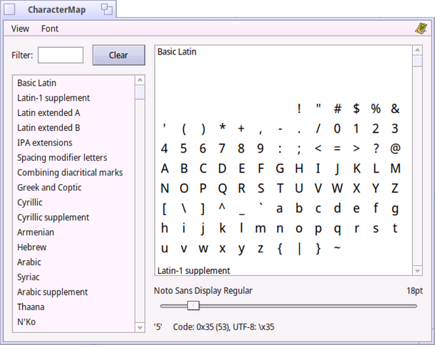

Another design option: the application icon is placed on the right side, like in Tracker. And for this icon can be assigned individual functions, depending on the application.
So, there is no need to change the existing menu design.

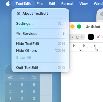

Itâs an Apple Mac convention - every Mac application has one, though with a text head label rather than an icon. 575âs proposal combines that with the Mac concept of the
menu item, which on Macs is a systems-related menu.
Considering that BeOS and Macs had a shared history in terms of personnel and design philosophy, I think it is a natural development for Haiku.

Another idea Iâd like to experiment with is allowing apps to add menu entries to their deskbar entry menu. And maybe also other things like being able to show progress bar status there where applicable (for example for Tracker copy operations, or Web+ downloads). That may be easier if there is a clearly defined âapplication menuâ. That would make more sense if the inspiration is the one from MacOS: the idea there is that that menu is accessible easily even if you donât really know where all windows for that app are, and it is not specific to one single window. It works in Mac OS where there is a global menu bar, but maybe not as well in Haiku with the menu bar being inside each window.
But then it may not need to be repeated into each window? Having it in DeskBar may be more useful, but if itâs just the âQuitâ option, thatâs already there.
While one may overlook that the app settings, quit, help etc. have nothing to do with files, those are often found under a âFileâ menu. But where to put them if the app doesnât deal with files? In an extra âApplicationâ menu; some use âAppâ, others the application name as menu label.
An app-icon menu would make this consistent, uses less space and has all the other minor advantages mention further up.
Yes, but it do not need introducing BApplicationMenuBar, only consolidating existing File/Application/< application name > menu to BIconMenuItem.
