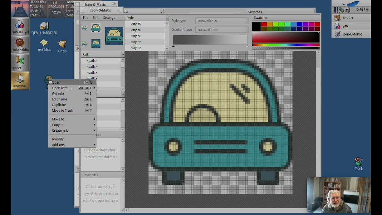

The easiest external format to use would be SVG since Haiku’s Vector Icon Format (HVIF) is also vectorized. To convert the icon you’ll have to try to import the SVG file into Icon-O-Matic and re-save it as an icon. I’m not sure how foolproof the conversion is. Haiku is still beta software, after all.

You can’t load a PNG bitmap into a vector image editor like Icon-O-Matic. It has to be a well-formed SVG. A PNG won’t ever work.
You can load a PNG into Icon-O-Matic and use it as background of the canvas, see “Add reference image” in the Shape menu. That helps to vectorize the image, which in this case should be quite easy.

Besides not being optimized, using some bitmap-to-vector tool often results in a mess of paths and shapes which makes it quite impossible to later modify the icon.
When it’s just two simple shapes, it may be a nice opportunity to discover how to use IOM.
