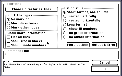

It’d be nice if something like Commando from A/UX exists for Haiku:
This alongside some of the features I already mentioned earlier would prolly be the farthest that the idea of a friendlier terminal could be taken without a native shell, but this may take an inordinate amount of effort.
