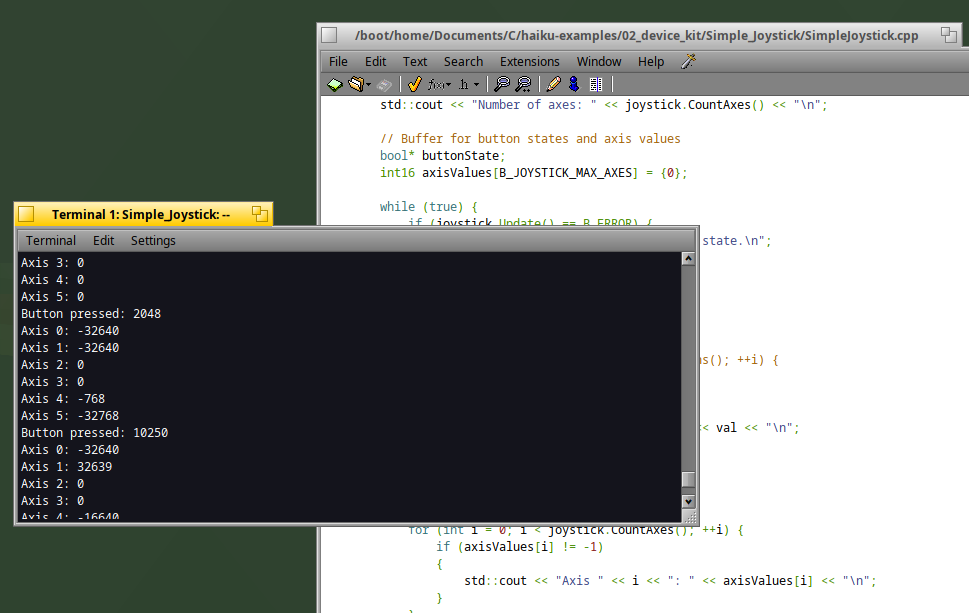

I’ve got a 8BitDo SN30 pro (USB) and the QuirkyDevices part need an update to recognize that gamepad.
So far a success because now my SimpleJoystick program is recognizing it:
I will look in more details later to clean up everything :slight_smile:
