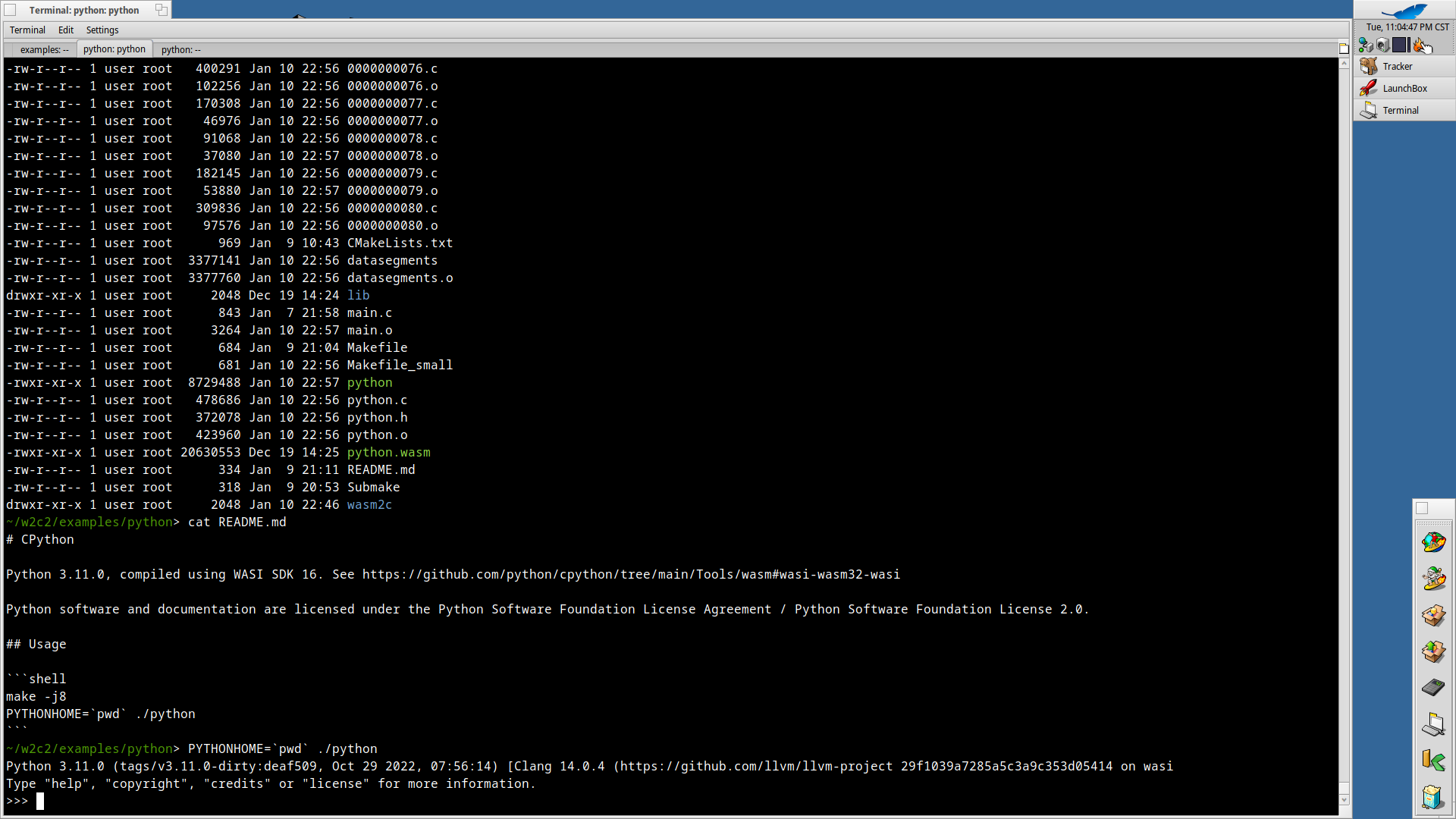

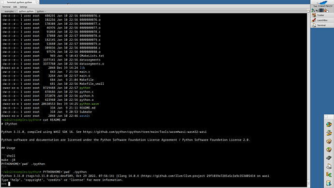

After last night’s fix of the parallel build system, W2C2 has converted Python 3.11 to multiple C source files such that they can be built using make -j8 on my system. I’ve actually run a debug build of the resultant binary! My thanks go out to Turbolent on GItHub for working on this project! I’m going to try to clean up the Makefile a little better to eliminate a currently necessary step in the build process.
This deserves a screenshot. Slightly modified the Makefile for size optimization instead of debug build and this was the outcome:
