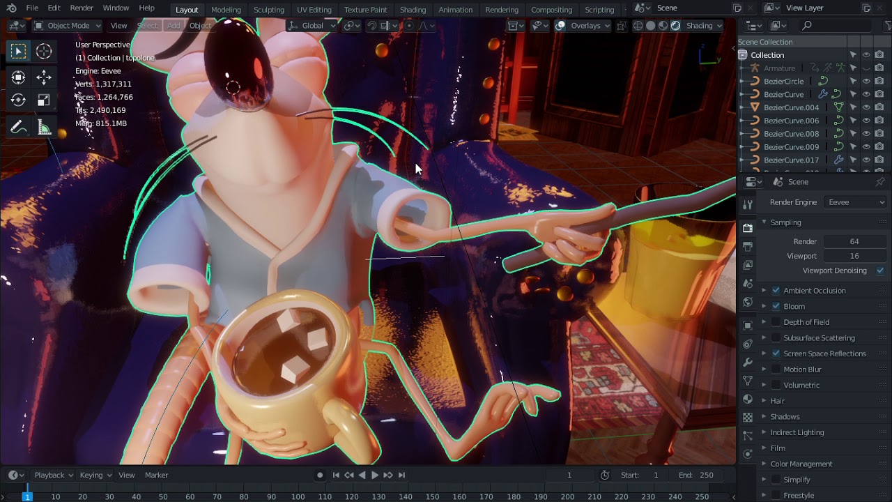

This is an old video from 2018 or 2019, which I used to report some bugs to the blender developers.
As you can see, EEVEE realtime rendering, is obviously not performing in realtime, but it allows a complete rendering in OpenGL, moreover, by deactivating the advanced shading it has excellent performances that allow modeling or other in blender, even with meshes with a consistent polygonal density.
