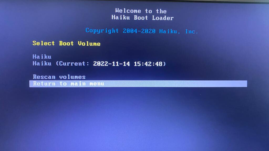

I have 2 disks in my computer, one with haiku and other with lnx. In the release of Beta4, the boot loader dont detect my other hd instalation. I try with one of the latest nightlis but same behabord. I download the hrev 54815 and the hd instalation is listed:
So, its a bug? or this change is expected?

Something change between hrev54815 and hrev56612. Both, pendrive and hd installs are 64bits, with hrev54815 (in the pendrive) the hd installation is listed in boot menu… if i use in the pendrive hrev56612 only the pendrive volume is listed. So, my question is… this is expected or its a bug?
Why would this be “expected”? Why would we decide to not show other disks? Of course it’s a bug.
It could be expected by a decision to not support this anymore. It could also be expected by the implementation of a new code that has not yet implemented this functionality. In short, it could be expected by an infinity of possibilities. It is clear now that then it is a bug… Thanks!
