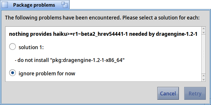

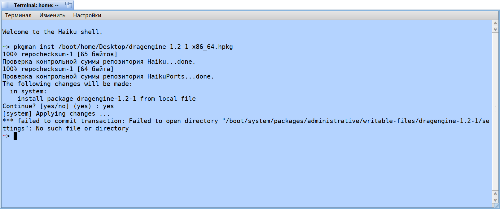

Hmm, it is not installable here on Haiku Beta2 64bit
Imgur
somethig went wrong
The devel also has same problems
Maybe you built it for 32bit only?
Better ask some porter or developers in IRC chat for help

I’ve uploaded new version of the package with the proper arch: dragengine-1.2-1-x86_64.hpkg, dragengine_devel-1.2-1-x86_64.hpkg.

I’ve modified the package scripts. I thought I have to put things in with “/boot/system/” but it looks like I need to strip this part of the file path.
I’ve re-uploaded the files dragengine-1.2-1-x86_64.hpkg, dragengine_devel-1.2-1-x86_64.hpkg. On my system they installed and run.

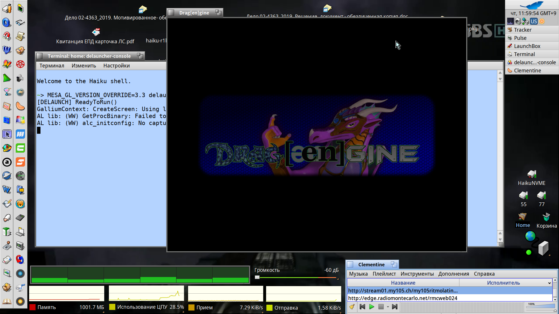

There is something I forgot mentioning. If you do not have MESA 19.1 chances are launching the engine fails with an OpenGL Error. In this case run it like this:
MESA_GL_VERSION_OVERRIDE=3.3 delauncher-console run -f DSTestProject.delga

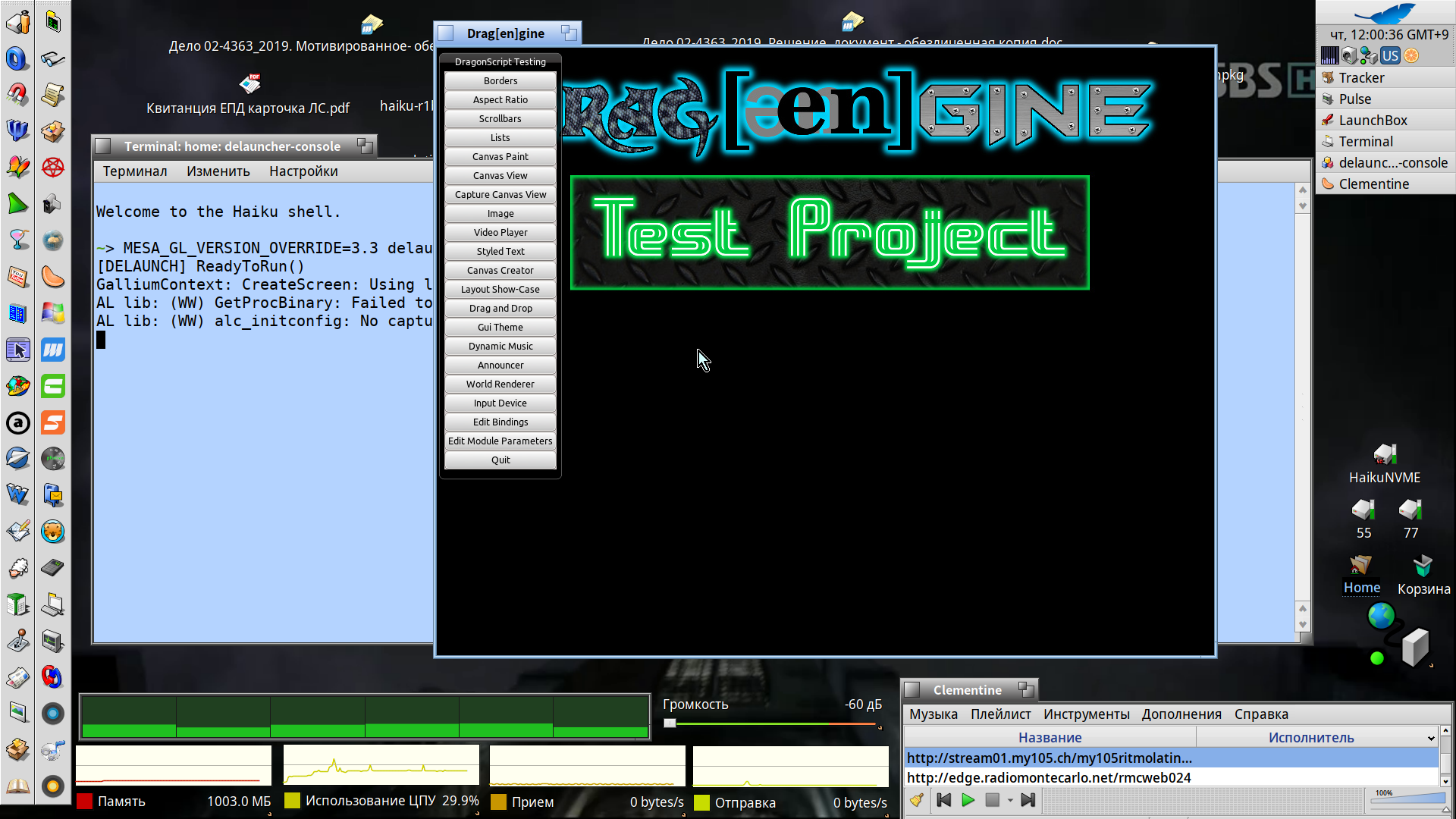

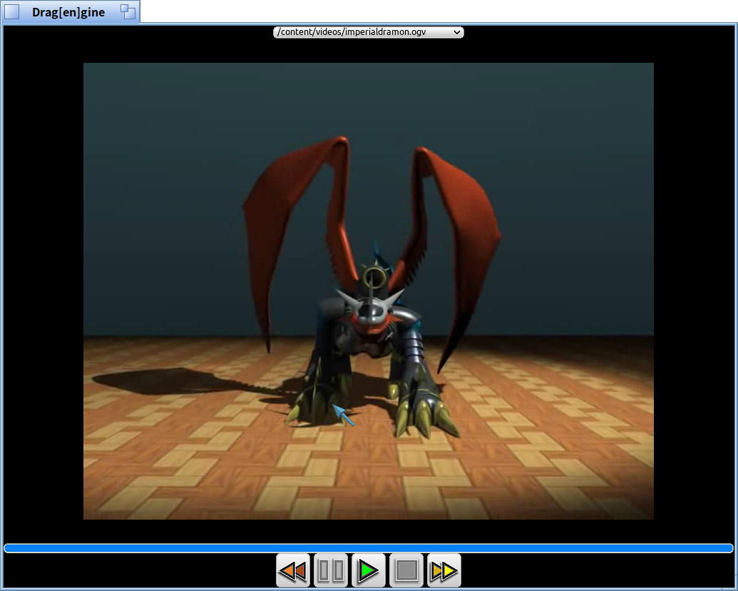

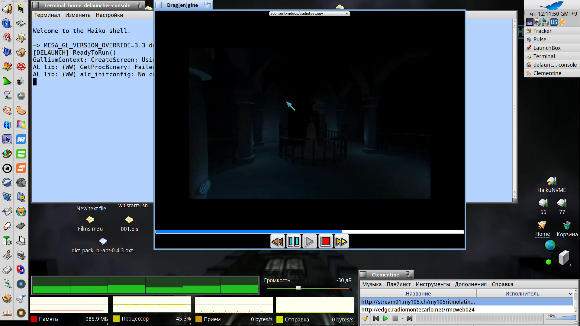

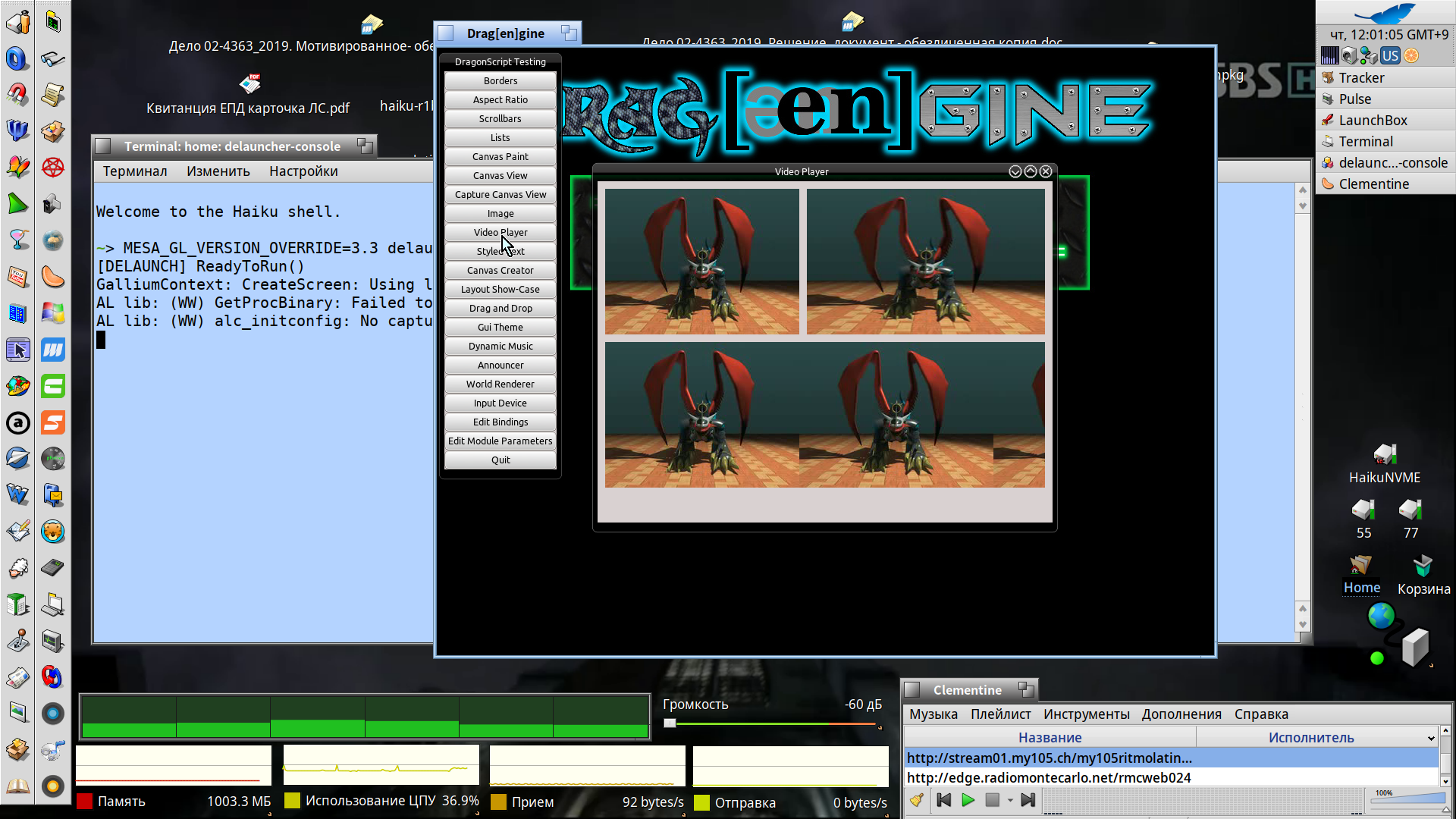

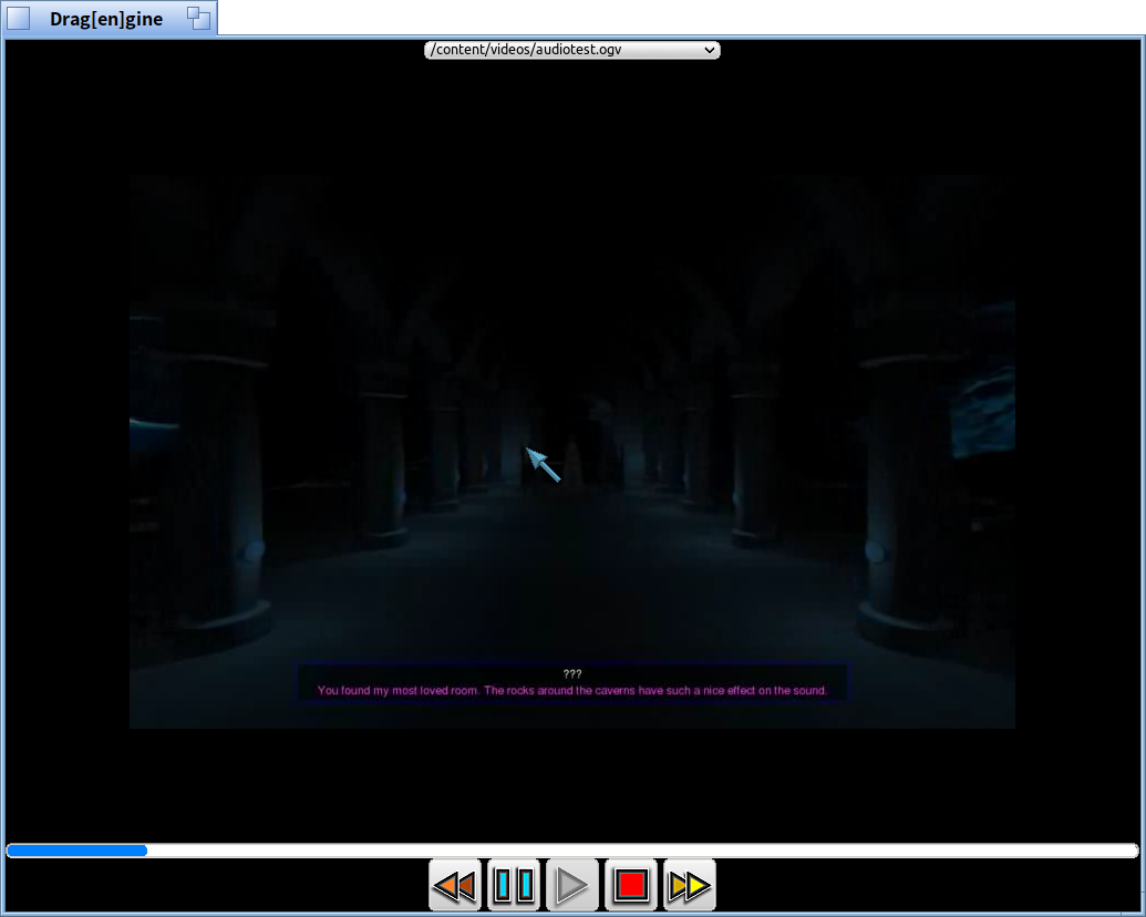

Runs fine now:
https://imgur.com/cSvLfLG
screenshot509
