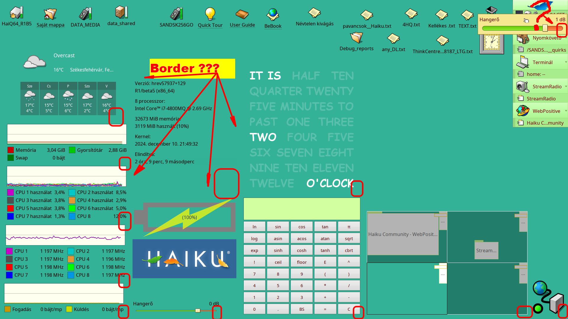

All the repliicants on my desktop
and
at its original program / applets
the displayed layout miss the usual little knobs that you can grab
and move the replicants by them.
Also frames are missing where there were presented earlier.
As it is missing at apps as well - drop replicants and re-create them also not possible.
There is only Workspaces where right click menu at least offers to remove the replicant.
As the moving knobs are not available .. the usual removing process : to drag & drop them into the Trash – does not work as well.
However as the knobs are missing at apps/applets as well .. it is not a problem at all : you cannot drag them onto desktop again. :joy:

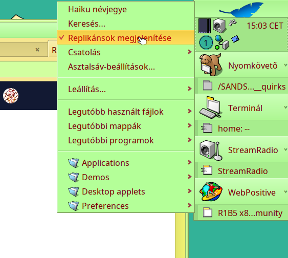

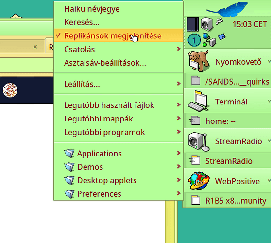

Should be an option in the Tracker or Desktop configuration, named “show replicant” or something like that (not in Haiku at this moment). Confirm that this option is enabled.
Thanks
okidoki, I check it.
EDIT :
OOOOKaaay, … I finally found it -
IT was the root cause … dunno when I clicked on it accidentally.
