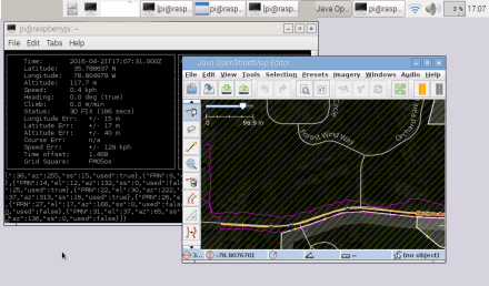

Hi: I want to hook my serial GPS up with Haiku, to use with the OpenStreetMaps editor (JOSM). I’m already running JOSM on Haiku (and it works great!). JOSM depends on the OpenJDK port, which seems to be doing well, so hats off to all those who contributed to OpenJDK being put on Haiku.
To make my own map tracks in JOSM requires the serial GPS input. What’s the status of serial comm on Haiku? On my Raspberry Pi, I can get the output from the serial GPS like so:
cat /dev/ttyAMA0 > myGPStrektrack1.nmea.
How to do the same on Haiku?
For anybody who’s running a Pi, here’s my setup for JOSM on that platform:
