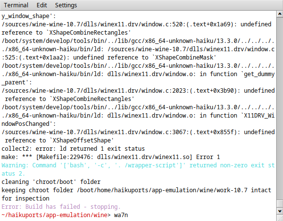

My first attempt compiling 10.7 using --with-x option failed.The recipe i used
worked before using --without-x and --with wayland…Any idea what makes the linker complain?
Should Lib -lXext be used?
For winex11.drv of wine-10.6 I used it in Makefile.in (in winex11.drv folder). Add a library reference -lXext:
-UNIX_LIBS = -lwin32u $(X_LIBS) $(PTHREAD_LIBS) -lm
+UNIX_LIBS = -lwin32u $(X_LIBS) $(PTHREAD_LIBS) -lm -lXext

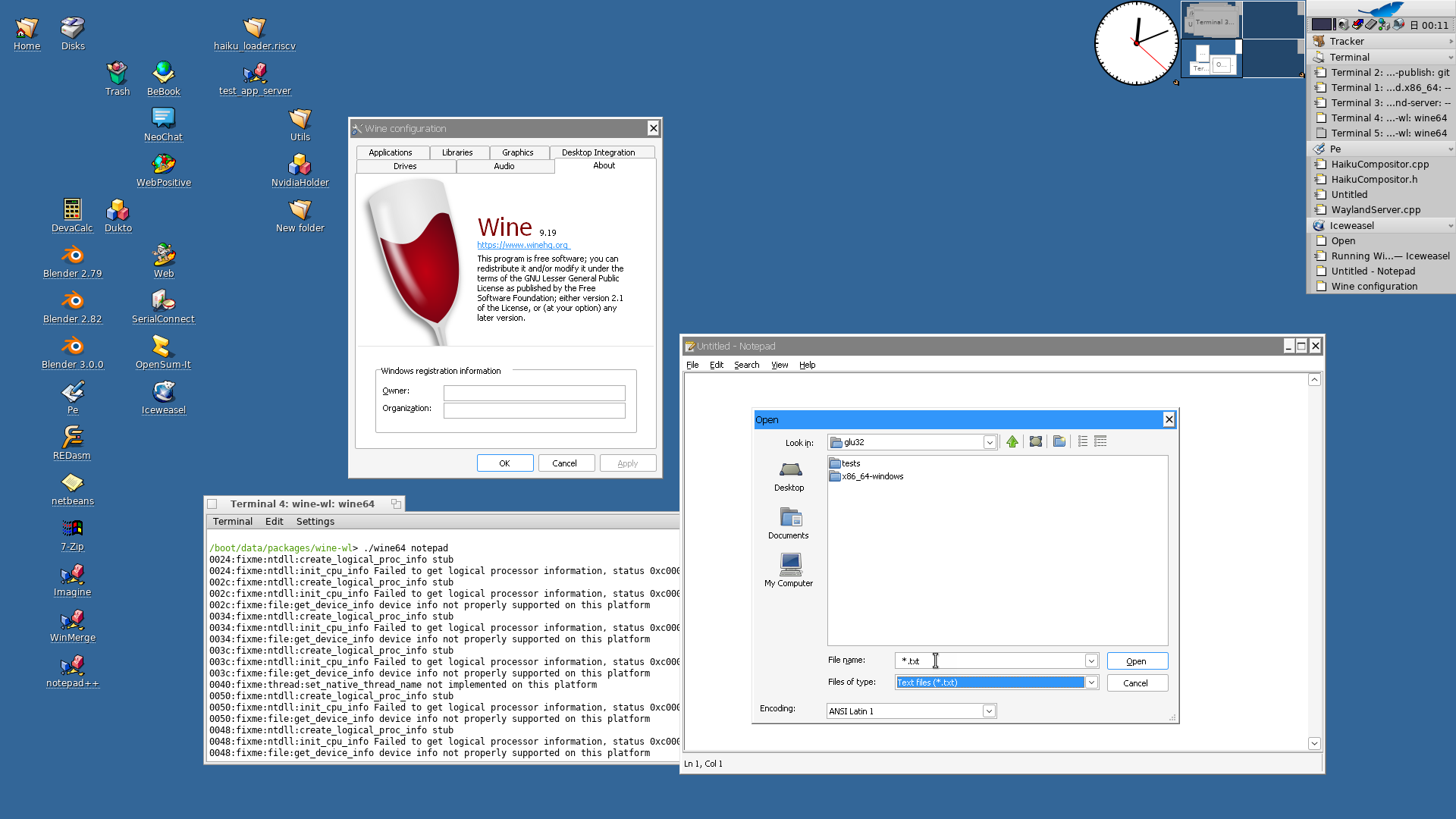

Nice.
So wine is working from packages also again? With nightly or beta5? Just asking.
Added wp_viewporter protocol implementation needed for Wine Wayland backend: implement `wl_presenter` protocol · X547/wayland-server@6614d17 · GitHub.
Are keyboard and mouse working ok after @X512 Wayland changes?
Are you mean that something regressed in my today changes?
I mean that when @Begasus tried to use @Sergei’s Wine 10.6 in X11 mode he reported that it was not production ready because of mouse input issues.
What about your version? Is everything working ok?
Furthermore is it possible for all the people who have a working version to provide hpkgs so other people can try stuff without recompiling?
Keyboard and mouse are working in my Wine Wayland build. But it has a trouble with popup windows clipped by parent window.
