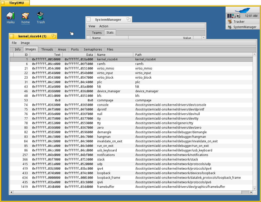

I made initial functional device manager v2 implementation enough to boot to desktop on TinyEMU.
Some design considerations:
  • C++ API is used, but only with pure virtual functions and no virtual destructors to allow potential use of C or Rust programming languages.
  • Unlike separate device and driver nodes in device manager v1, only one node is used both for device and driver. Device node expose 2 interfaces: bus interface set by bus manager when registering node and driver interface provided by dynamically found and attached device driver module.
  • Drivers may provide multiple interfaces identified by interface name string. It allows to export multiple different interfaces or different versions of the same interface for backward compatibility.
  • Device node supports only single driver. For multi-driver nodes such as root node, new child node is automatically created. Parent node have control over creation of child node and it can set bus driver interface.
  • “Device” is renamed to “DevFsNode” to avoid confusion.
  • Device manager is moved to separate add-on for now (can be moved back later).
Device node tree:
Node tree:
Node("Devices Root"): no driver
  Node("Root subnode"): bus_managers/fdt/driver/v1
    Node("Root"): no driver
      Node("cpus"): no driver
        Node("cpu@0"): no driver
          Node("interrupt-controller"): no driver
      Node("memory@80000000"): no driver
      Node("htif"): no driver
      Node("soc"): no driver
        Node("clint@2000000"): no driver
        Node("plic@40100000"): interrupt_controllers/plic/driver/v1
        Node("serial@10000000"): no driver
        Node("virtio@40010000"): busses/virtio/virtio_mmio/driver/v1
          Node("Virtio MMIO"): no driver
        Node("virtio@40011000"): busses/virtio/virtio_mmio/driver/v1
        Node("virtio@40012000"): busses/virtio/virtio_mmio/driver/v1
          Node("Virtio MMIO"): drivers/disk/virtual/virtio_block/driver/v1
        Node("virtio@40013000"): busses/virtio/virtio_mmio/driver/v1
          Node("Virtio MMIO"): drivers/input/virtio_input/driver/v1
        Node("virtio@40014000"): busses/virtio/virtio_mmio/driver/v1
        Node("framebuffer@41000000"): no driver
      Node("chosen"): no driver
