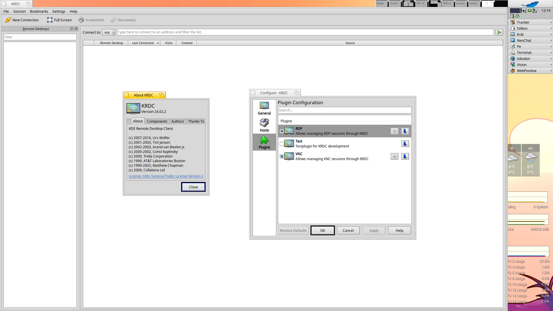

Checking out latest KRDC (24.02.2) against an slightly updated freerdp (2.10.0) is working so far in terms of building showing the options, now checking on 32bit, and then I guess I need to figure out how to be able to connect both machines together :slight_smile:
