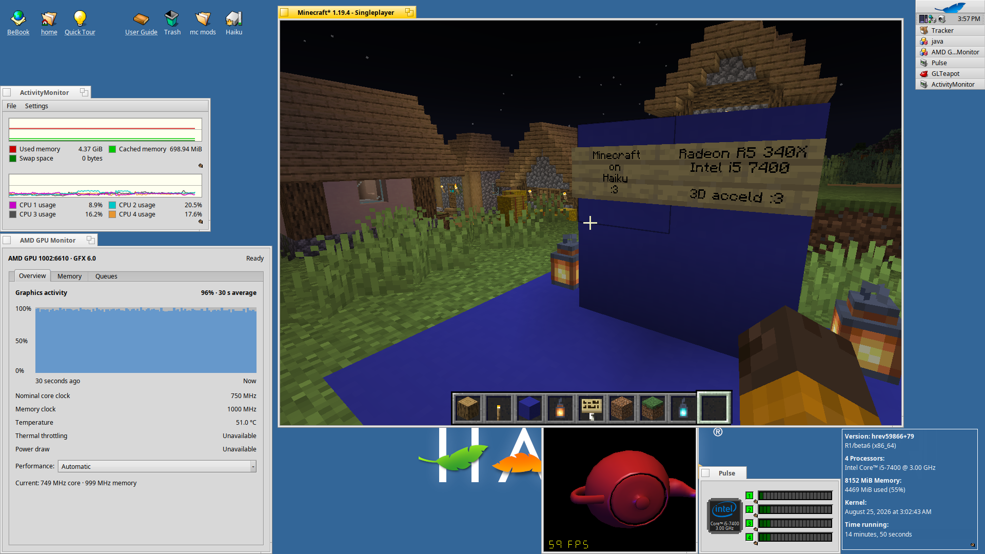

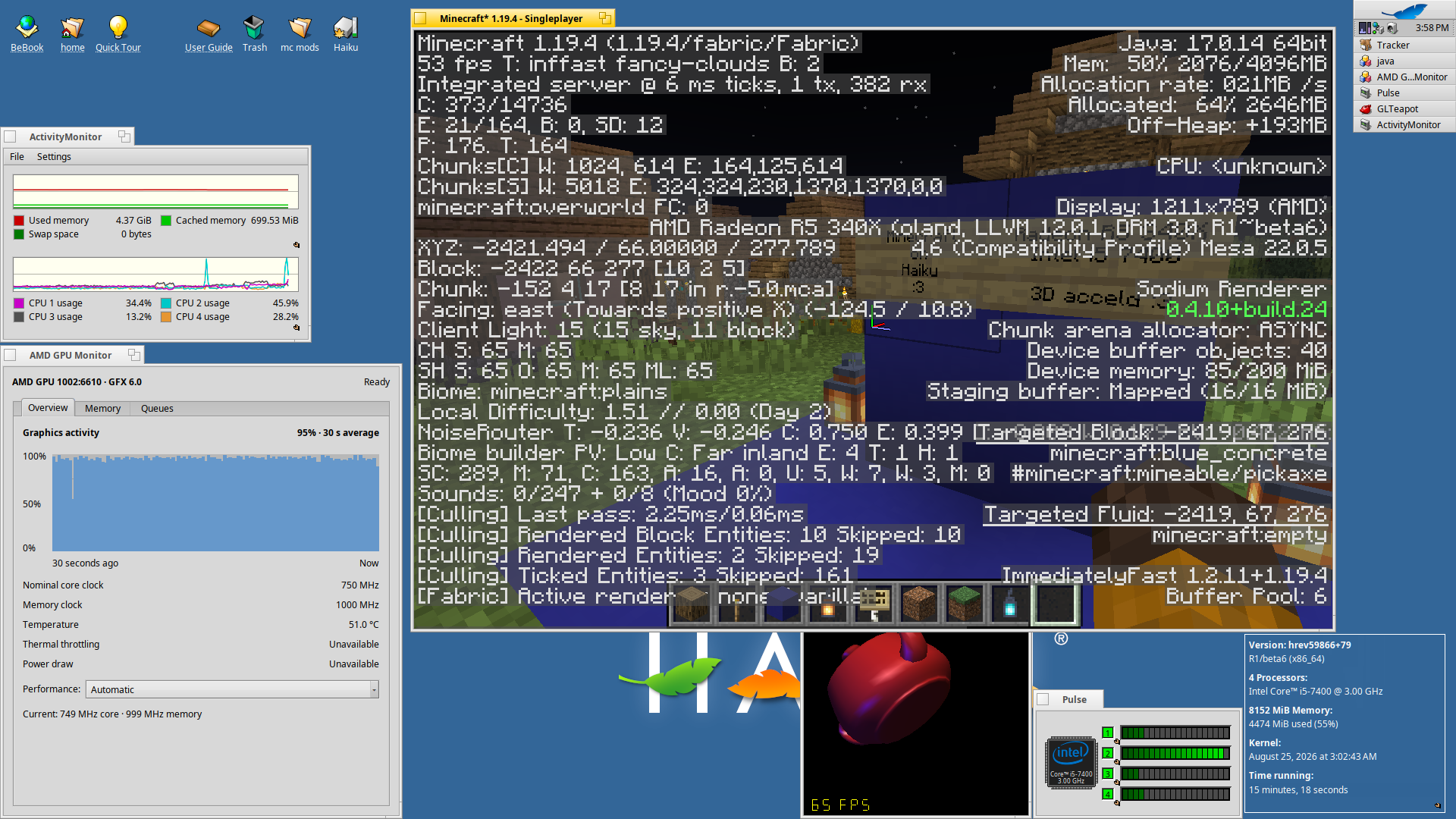

R5 340X working on Haiku
back again with some more gpu stuff !
here is the radeon R5 340X working with opengl on haiku :3

Whats the newset gpu this supports?
right now it only really works on the mullins iGPU in a thin client i have, and on the oland r5 340x i had laying around
i do have another thin client with a vega 8 though, could try adding that but that would maybe be a bit on the harder side of things lol
