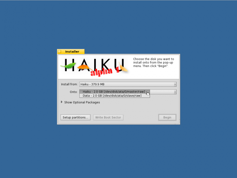

Basically you got it right, although you don’t need to reinstall Haiku if it is already installed. Just start up the LiveCD again and run bootman from the terminal. Oh and, in case you missed it in the installation process, make sure the Haiku partition is bootable. See this option here called “Write Boot Sector”? http://www.haiku-os.org/files/slideshow/Haiku_Slideshow/04_install-cd_select-target-partition.png
If you missed it, just open it up again, choose your partition, and click it.
