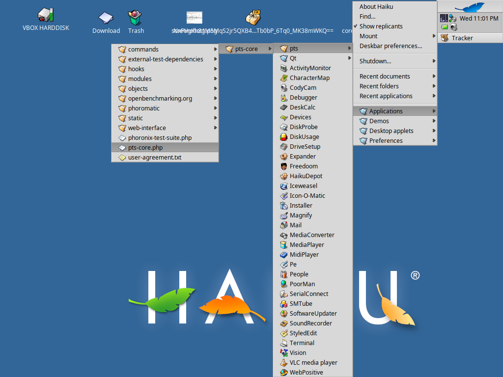

Thanks for your feedback.I was able to create a recipe that downloads the product,applies a patchset file and creates a hpkg…the main issue after installing the hpkg is that a Deskbar shortcut is created that contains all the folders of the product…
But i want to call php for the correct file adding also a argument …e.g php phoronix-test-suite.php interactive …any advice?
Using recipes, links in the Applications are added by addAppDeskbarSymlink, make sure you don’t link folders.
In a situation like yours usually make a script, add it into the “additional files” of the recipe and then copy it to the apps directory and use addAppDeskbarSymlink to make a link that points at that script.
Freedoom’s recipe also does it, so you can still look there for more pointers.

if i click on the deskbar link i see that a team with the php command running but i dont see a terminal window…any idea what am i missing here?
P.S i found the reason…. You should call Terminal in the .sh file
