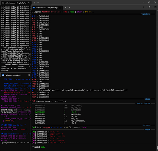

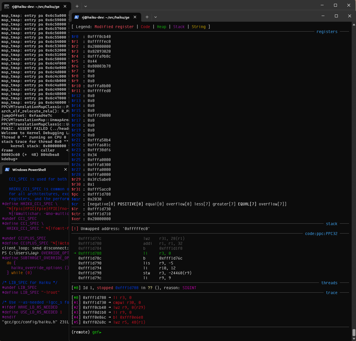

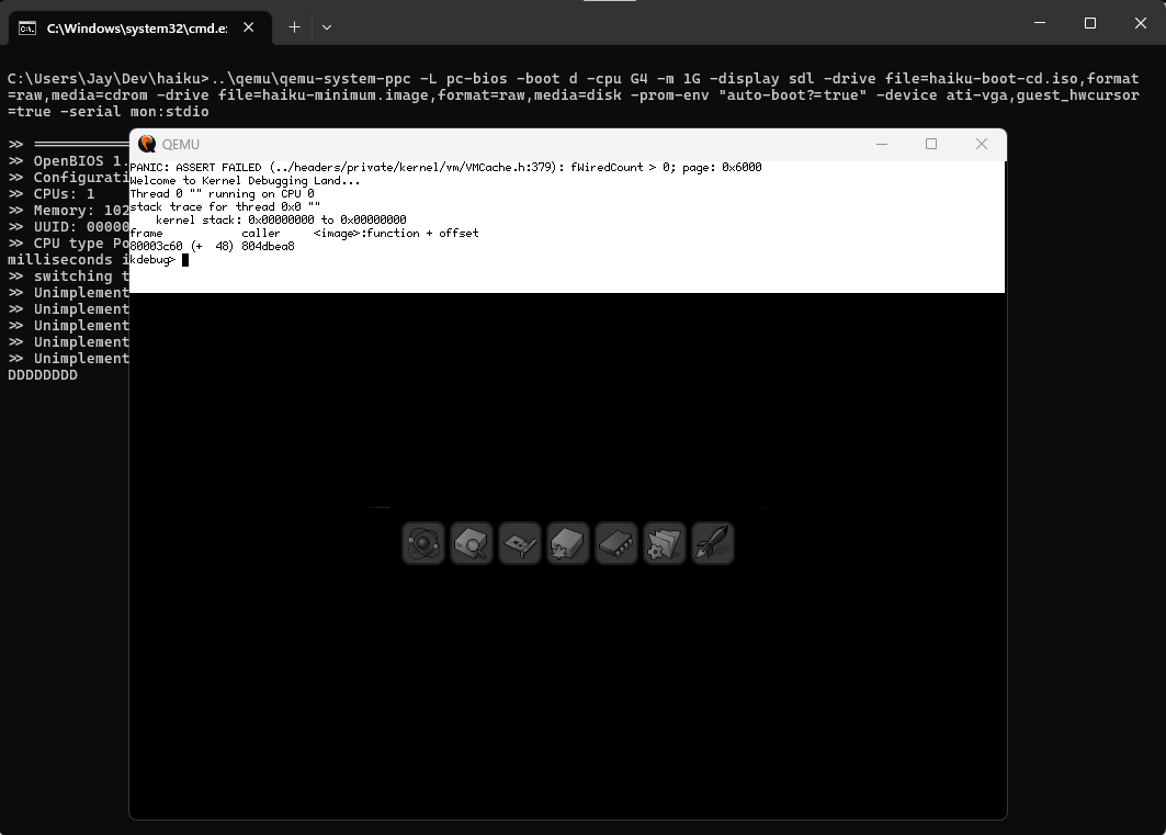

Hello,
I didn’t want to get anyone false hopes - myself included - so I’ve refrained from creating a dedicated “port progress” topic (à-la-X512 :star_struck:); but following this post, it’s feeling more and more like a missed opportunity to keep this under wraps, so…
I’ve been toying with the idea of bringing back the PowerPC port up for (quite) a while and I’m beginning to make some (light) progress on my end. Please keep in mind that we’re speaking
about a REAAAAALLLY early stage, nothing to show besides a few black-ish screenshots and kdebug output : we’re nowhere near getting an installable image on your Mac (or mine FWIW).
For the time being, the initial target is Qemu, but I’ve plenty of old PPC hardware in working condition to move to bare metal if I manage to pull this out (no G5 unfortunately, but I’m keeping my eyes open)
Regarding current status : after some issue porting my patch-set from gcc 8 to 11, and now 13.2, I’m back on track to the peculiarities of the MMU early initialization code. I was hoping to get past this before sending back patches for review.
PPC is a non-relevant architecture nowadays (well at least, Apple hardware using PPC is), but I find the idea quite appealing to get BeOS/Haiku booting back on the very first CPU architecture it supported (if we omit the Hobbit of course) and I’d be very proud if I could play a tiny part in this software/hardware preservation effort and display this screen one day :

how did you build the toolchain for ppc? any patching needed on top of btrev43208?

Yes there are some additional patch required, mainly due to changes in svr4.h and rs6000 core expectations about it. My patches are probably non…conventional in this area, but at least getting out a loadable binary. I’ll post it on gerrit after a little cleanup.
There’s a whole subject I’ll need to dig up later regarding Secure-PLT in the toolchain (which I’ve kept disabled for the time being), but it’s a story for another day !

Hit a small (?) bump with relocations today, but I’ll keep pushing. Thanks for your confidence.
