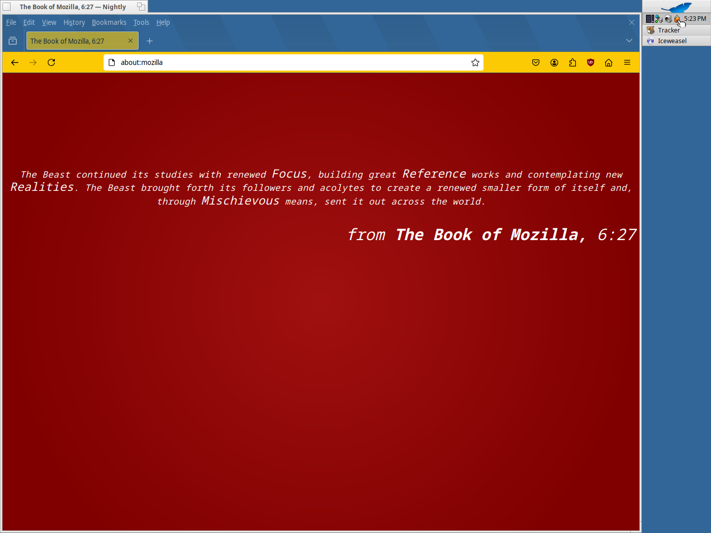

Even with just the options available in Firefox IceWeasel itself, it can be made to fit in a bit better with the rest of Haiku.
Menu bar and title bar
  1. Right-click on the toolbar (under the tab bar)
  2. Click on Customise Toolbar...
  3. Enable Title bar at the bottom left of the page that opens
  4. Open the Toolbars menu right next to it
  5. Enable the Menu bar option (web browser may crash afterwards)
Compact UI
  1. Go to about:configand accept the risks of opening it
  2. Search browser.compactmode.show
  3. Set browser.compactmode.show to true
  4. Right-click on the toolbar (under the tab bar)
  5. Click on Customise Toolbar...
  6. Open the Density menu at the bottom left of the page that opens
  7. Click on the Compact setting to change the UI density
This is what IceWeasel looks like with these settings enabled:

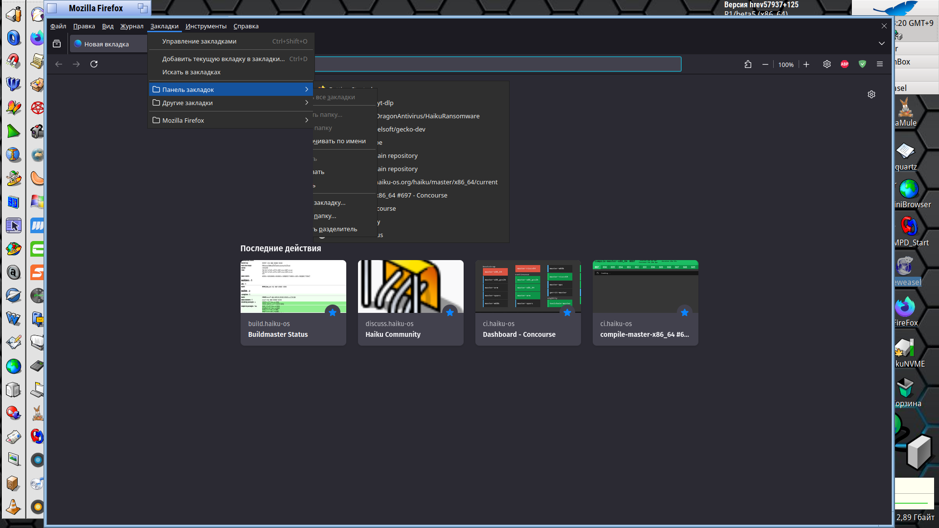

Menu bug - 64 bit hrev57937+125 IceWeasel
Suspecting wayland-server bug, but need more information, instruction how to reproduce etc…
Обрезание меню при наложении двух меню.
Cropping menu when two menus overlap.
This is GUI bug in redraw, when newly opened submenu only redraws the area of itself, but not of previously opened one. This leads to drawing artifacts of previous menu (now inactive) drawn next to current one (active).
