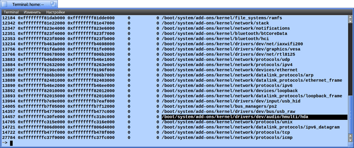

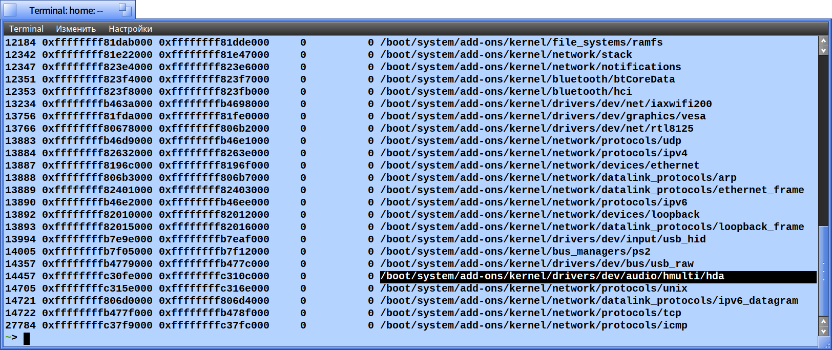

im not sure what you mean by compatible headphones, but after removing opensound and restarting the media twice i still do not have sound. should i update to a nightly?
In Terminal
listusb -v
listdev
sysinfo
listimage 1
listusb

listdev
device Bridge (Host bridge) [6|0|0]
vendor 8086: Intel Corporation
device a707: Raptor Lake-P/U 4p+8e cores Host Bridge/DRAM Controller
device Display controller (VGA compatible controller, VGA controller) [3|0|0]
device a7a0: Raptor Lake-P [Iris Xe Graphics]
device Signal processing controller [11|80|0]
device a71d: Raptor Lake Dynamic Platform and Thermal Framework Processor Participant
device Bridge (PCI bridge, Normal decode) [6|4|0]
device a74d: Raptor Lake PCIe 4.0 Graphics Port
device a73d: Unknown
device Mass storage controller (Non-Volatile memory controller, NVM Ex [1|8|2]
vendor 1c5c: SK hynix
device 1d59: BC901 NVMe Solid State Drive (DRAM-less)
device a76e: Raptor Lake-P Thunderbolt 4 PCI Express Root Port #0
device a72f: Raptor Lake-P Thunderbolt 4 PCI Express Root Port #2
device Generic system peripheral [8|80|0]
device a74f: GNA Scoring Accelerator module
device a77d: Raptor Lake Crashlog and Telemetry
device Serial bus controller (USB controller, XHCI) [c|3|30]
device a71e: Raptor Lake-P Thunderbolt 4 USB Controller
device Hub (Unused, Full speed (or root) hub) [9|0|0]
vendor 0000: Unknown
device 0000: Unknown
device Serial bus controller (USB controller, USB4 Host Interface) [c|3|40]
device a73e: Raptor Lake-P Thunderbolt 4 NHI #0
device a76d: Raptor Lake-P Thunderbolt 4 NHI #1
device Communication controller (Serial controller, 8250) [7|0|0]
device 51fc: Alder Lake-P Integrated Sensor Hub
device 51ed: Alder Lake PCH USB 3.2 xHCI Host Controller
  device Application Specific Interface (Device Firmware Update) [fe|1|1]
    vendor 04f2: Chicony Electronics Co., Ltd
    device b7b7: Unknown
  device Wireless (Radio Frequency, Bluetooth) [e0|1|1]
    vendor 8087: Intel Corp.
    device 0033: AX211 Bluetooth
  device Human Interface Device (Boot Interface Subclass, Mouse) [3|1|2]
    vendor 046d: Logitech, Inc.
    device c077: Mouse
device Memory controller (RAM memory) [5|0|0]
device 51ef: Alder Lake PCH Shared SRAM
device Network controller [2|80|0]
device 51f1: Raptor Lake PCH CNVi WiFi
device Serial bus controller [c|80|0]
device 51e8: Alder Lake PCH Serial IO I2C Controller #0
device 51e9: Alder Lake PCH Serial IO I2C Controller #1
device Communication controller [7|80|0]
device 51e0: Alder Lake PCH HECI Controller
device Bridge (ISA bridge) [6|1|0]
device 519d: Raptor Lake LPC/eSPI Controller
device Multimedia controller (Multimedia audio controller) [4|1|0]
device 51ca: Raptor Lake-P/U/H cAVS
device Serial bus controller (SMBus) [c|5|0]
device 51a3: Alder Lake PCH-P SMBus Host Controller
device 51a4: Alder Lake-P PCH SPI Controller
sysinfo

~> listimage 1
Loaded audio-driver HDA
You are probably just out of luck on this machine, but if you want help, we need a lot more info than this is a somewhat modern laptop.
Manufacturer, Model, soundchip hardware.
Paste at least the output of listdev and listusb in the haiku terminal.
For your information, sound on haiku is working on a lot of devices, including
Lenovo x200,x201,x301,x220,x230,T430(s),T460(s),T470(s),T14gen4_intel
I would try doing that, but it not %100 guaranteed that it will fix the sound, what I did is just use a external peripheral for sound and mouse support so I would recommend that but you may not have sound support at all until Haiku make upgrades to the sound system
its on the system. but how do i open it
parametr “-1” invalid
use “ listimage 1 “
i have done that. but i cannot find the hda driver in this list. however the OSS driver is showing (/boot/system/add-ons/kernel/drivers/dev/oss/oss_loader
The audio card ID device 51ca is currently unsupported.
Please create a new ticket in the bug tracker at the following link:
https://dev.haiku-os.org/newticket
thanks for help
If you install opensound, the default hda driver is automatically disabled. If you want to try the hda driver, you need to uninstall opensound.
