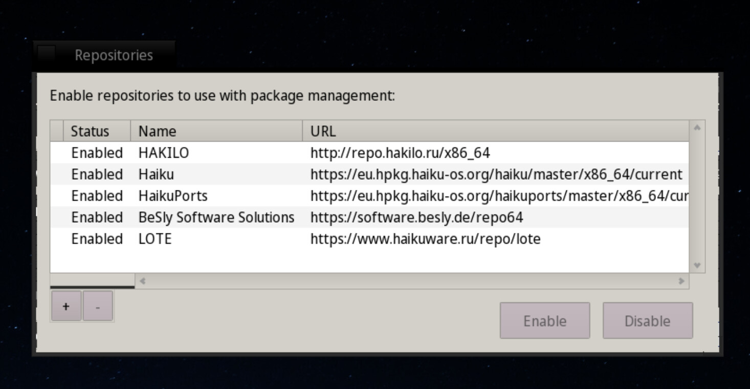

As a side note, you shouldn’t use Flat decorator/ control look at the moment, to avoid these holes between borders and windows. The hole in repository window ( above + and - buttons) is present with all control look when you raise font size and should be fixed. I don’t know if there is a bug report for that already.
I think nightlies have moved to r1beta4, so you need to change or add both repositories for haiku and haikuports (just change master to r1beta4 for both).
HaikuPorts now has WebKit_GTK, Wayland_protocols and other popular packages. Perhaps your other repos have versions of the same packages, causing a namespace collision.
