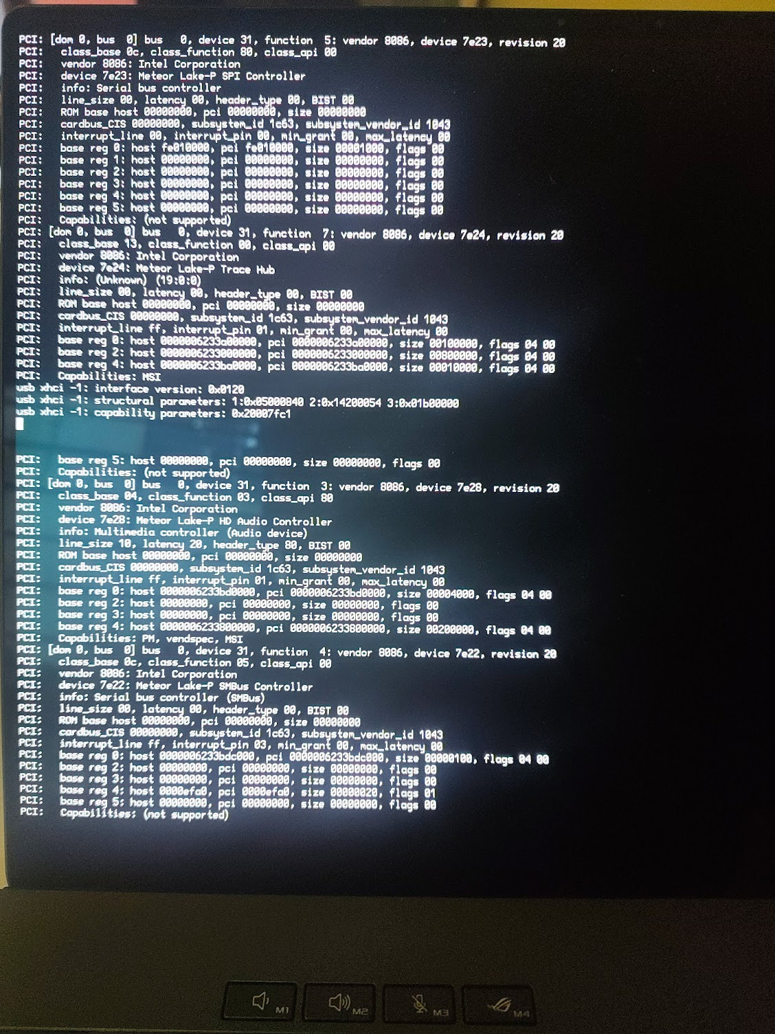

  • I tried to run it natively on my PC (Asus ROG Zephyrus G16) but it got stuck at the splash screen. How do i debug it and fix issues corresponding to my laptop?

The boot process for my laptop gets stuck at the hard drive (the fourth) logo, meaning it doesn’t light up.

What version of Haiku, did you try? I guess that on modern hardware you went for a 64 bits but was it Beta 5 or nightly?
From what kind of media did you try? An USB key, an optical drive?
Also, at the moment, NVMe drives should work but, eMMC drives are not supported. perhaps is it the reason of your problem?
Anyway, check Haiku User Guide and Troubleshooting on the main site. ReportingBugs page on bugtracker is also full of good informations.
When press shift or space during early boot, you should enter the boot menu. There you can try to enable some debug options, like disabling ACPI, or enable on-screen debug output.
I tried the Beta 5 x64 one from a USB Drive, I’ll find a way to get logs.
I got these logs
It’s the same in the latest nightly build and Beta 5

It didn’t get stuck at the last icon but at the fourth icon.
I think it’s something related to USB 3.0 but I believe that was fixed a long time ago.

The boot stopping here may be totally unrelated to XHCI, and instead is caused by timer interrupts not working (XHCI may just be the first thing that actually relies on them firing.) That usually means APIC was configured incorrectly. There were fixes on the nightlies that will affect this; are you sure beta5 and nightly stop at the exact same place?

I tried USB2 stick too, things are the same unfortunately.
Yes I’m sure, I am currently on hrev59701.

Hi, you might want to retest on hrev59733 or later (just committed, it should be in tonight’s builds.) This might fix some problems initializing the hardware timers on some systems.
Hi, this build too stops at the same place. The usb xhci one.
Ah well, thanks for testing anyway.
