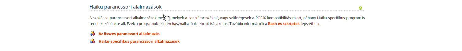

You have an icon on your desktop – User guide. Click on it. It will open in Webpositive from your machine, so if you do not have – working – network access it will work for you.
There is a section - at about first 3rd of sections or chapters
file:///boot/system/documentation/userguide//applications.html#cli-apps
was hu for me, replace with your language code to get this position – in your languege ( not mine as in the example below)
It is the offline version of User Guide, that you can find also on the Haiku site as well - by default in English, but you can switch the language there as well, however some parts may not translated on your language. The English version is full , complete - surely in the online version.

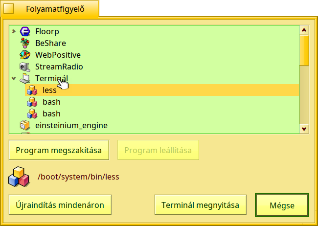

    Graphically, there is Team Monitor or Process Monitor application - getting with
    {CTRL} + {ALT} + {DEL}.
As you can see, you can roll down - as I did - Terminal and you can kill Terminal sessions, If you need those, but those won’t terminate commands that went into background, from any of those sessions. My sessions are on different Terminal pages than instances. I have one Terminal window with more sessions generally.
