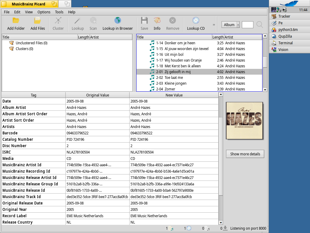

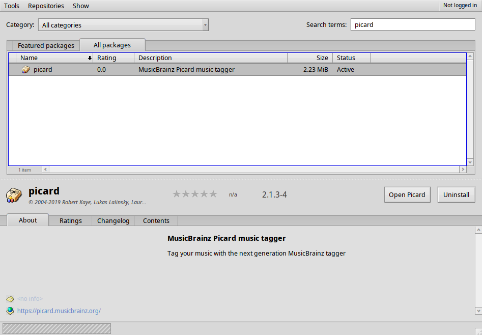

Yes, this is available in Haiku Depot. Search for Picard and you should find it:
A short update on my plans here. This is already in a very good shaped, I’m pretty pleased this runs so well on Haiku. So I will focus on getting the upcoming release of Picard 2.2 (which we plan to release in September) available on Haiku as soon as it gets released.
Some things to note:

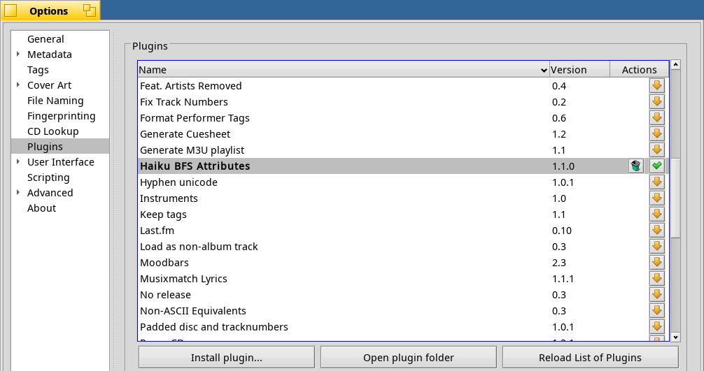

There is now a fully working plugin to read and write BFS attributes. It is using libbe directly and works pretty well. It is already available in the official plugin repository, but only if running the latest Picard development version from git. But that means this will be available with Picard 2.2 as soon as it gets released.
I would like to address the current patches by moving them to the proper place. E.g. the fixes for opening the web browser should be really provided by Haiku’s python packages. I will also see that the necessary changes to Picard itself get upstreamed.

Haiku users might want to install the “Haiku BFS Attributes” plugin which is officially available:
Great news, hope it can batch copy the id3 tags to attributes. Will test it.
