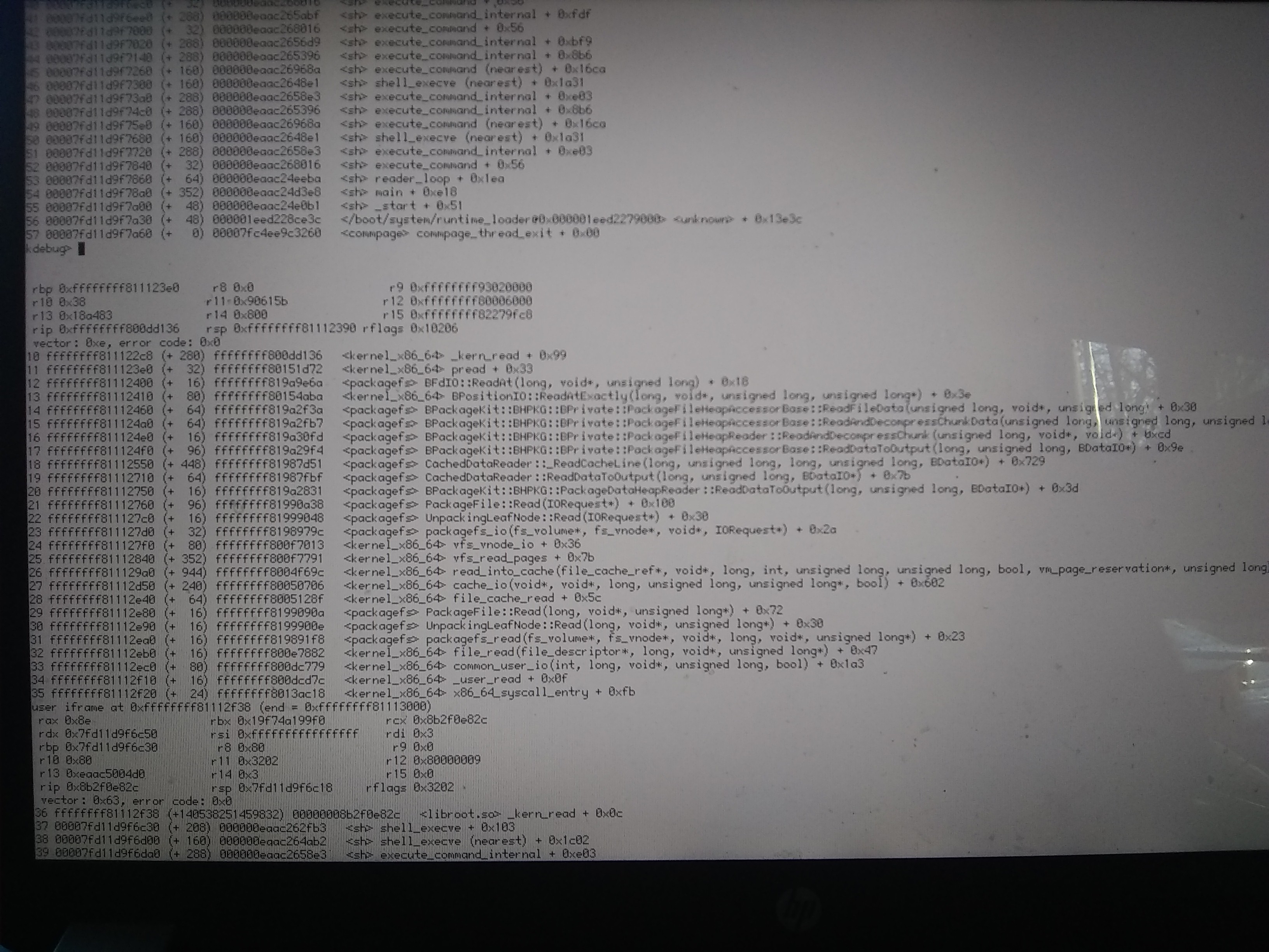

Found the boot menu and enabled debug on screen. Wish it did half screen debug and showed the splash icons to get an idea where I was in the process. Didn’t have access to camera yet. Seems to be cycling through trying storage device and filesystems. Watching debug, system seems to hang during this cycling, then I can page through, then hangs, then pages through… I got tired of paging through after a few minutes since I didn’t have my camera. In non-on-screen-debug, the splash screen icons go by rather rapidly, then screen switch then nothing.

On a hunch from the debug screen, I figured that it was somewhere in package management. I popped in the latest, greatest R1A4 USB key available and booted up like lightning. I discovered I have a quad core. Not bad for a free, practically barely used laptop. Someone spilled programming fluid in the keyboard, so a few keys don’t work. I have a portable USB keyboard, so wah.
The problem happens while the package system is trying to read some files. So it may be a problem with the CD or USB drive you used (especially if you used a different one to try R1a4).
Okay. Starting to make sense. Yes, it was a different USB stick. Could it possibly be due to the fact that the one I first used has multiple partitions?
Update: perhaps not. I replaced the R1A4 install with the latest nightly. Similar kdl output as before. Replaced it again with R1A4 and it booted fine again. All the same stick, just rewriting each time.
