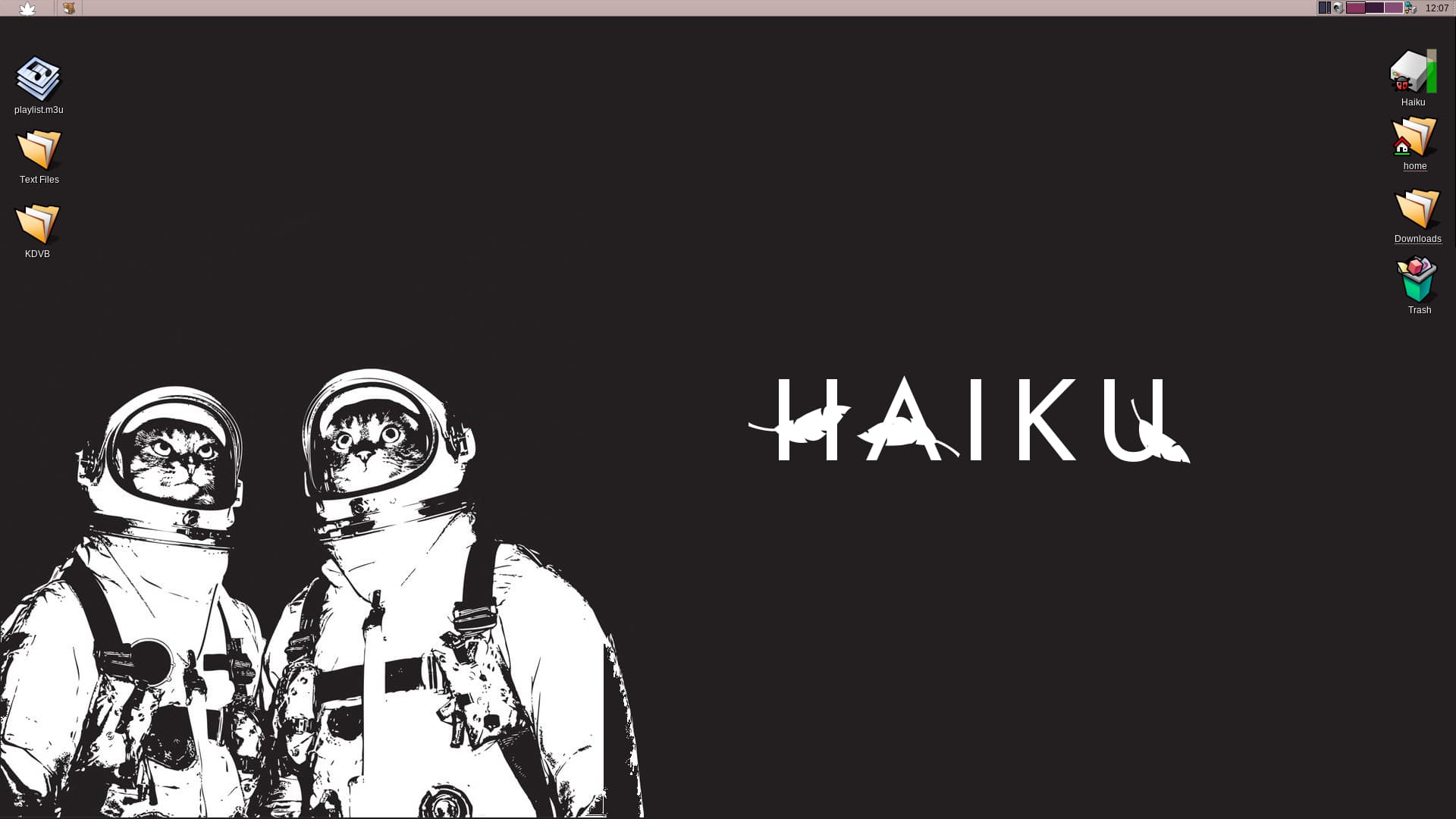

I’m not happy with how it looks yet but here is how it looks with a changed icon. I also have an older screenshot with the Haiku logo but can’t find it.
Looks like those cats are wondering where has gone the blue leaf. :smiley:
I thought cats couldn’t stand microgravity. :wink:
Cats can see in the dark !
