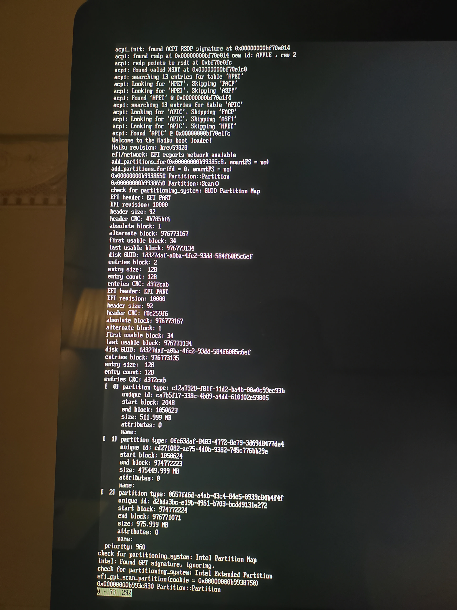

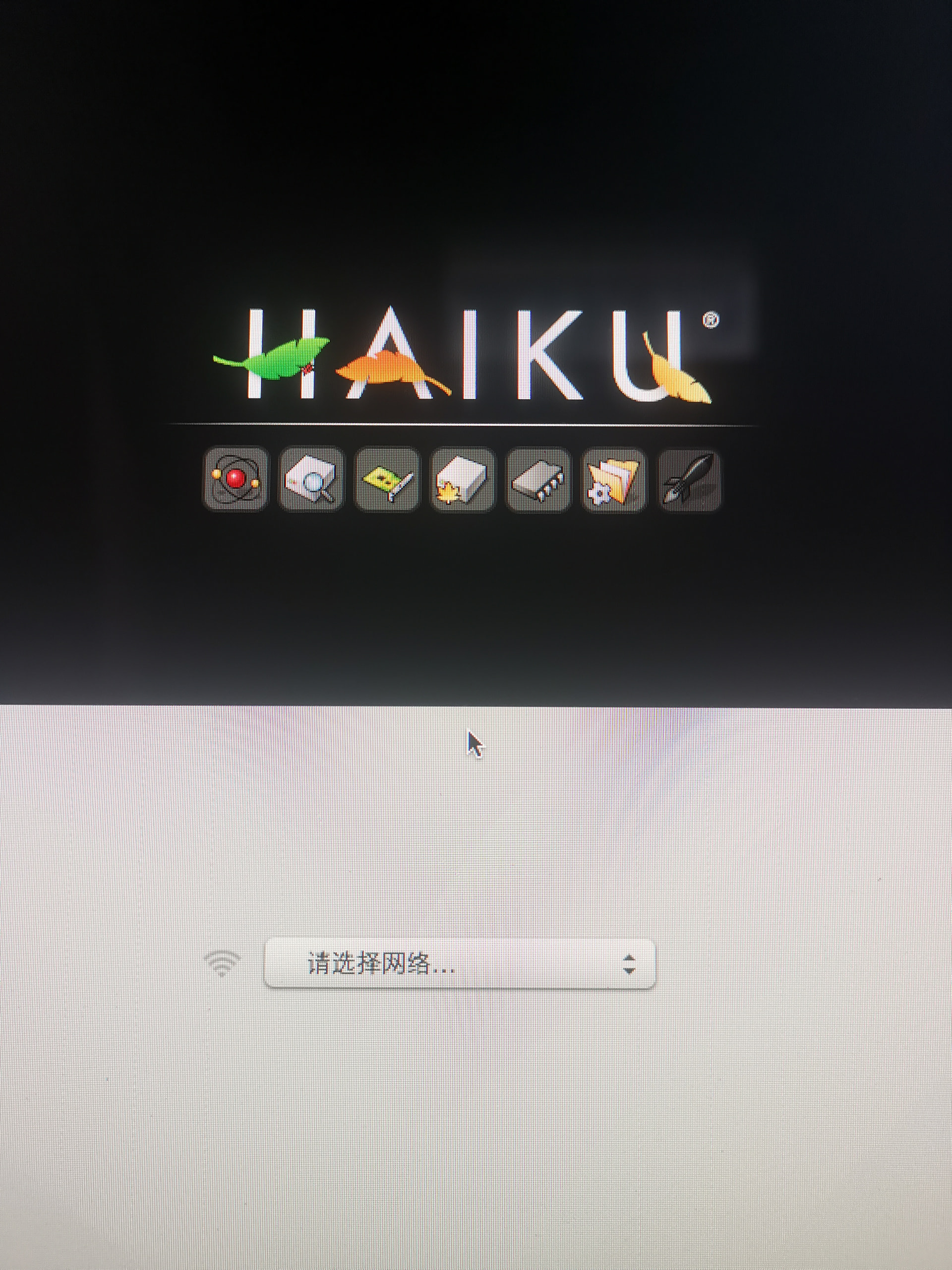

Now whenever I try to boot the system via a USB drive, the boot process freezes at the last loading icon. This happens with both the latest nightly build and the R1 version. Does anyone know how to fix this issue?

I’ve tried all the methods you suggested, but the problem persists.
I still cannot access the boot menu options at all.

If I hold down the Shift key or repeatedly tap the Spacebar once on that selection screen, the system crashes instantly.
If I press no keys at all during bootup, the boot process hangs at the final loading icon.

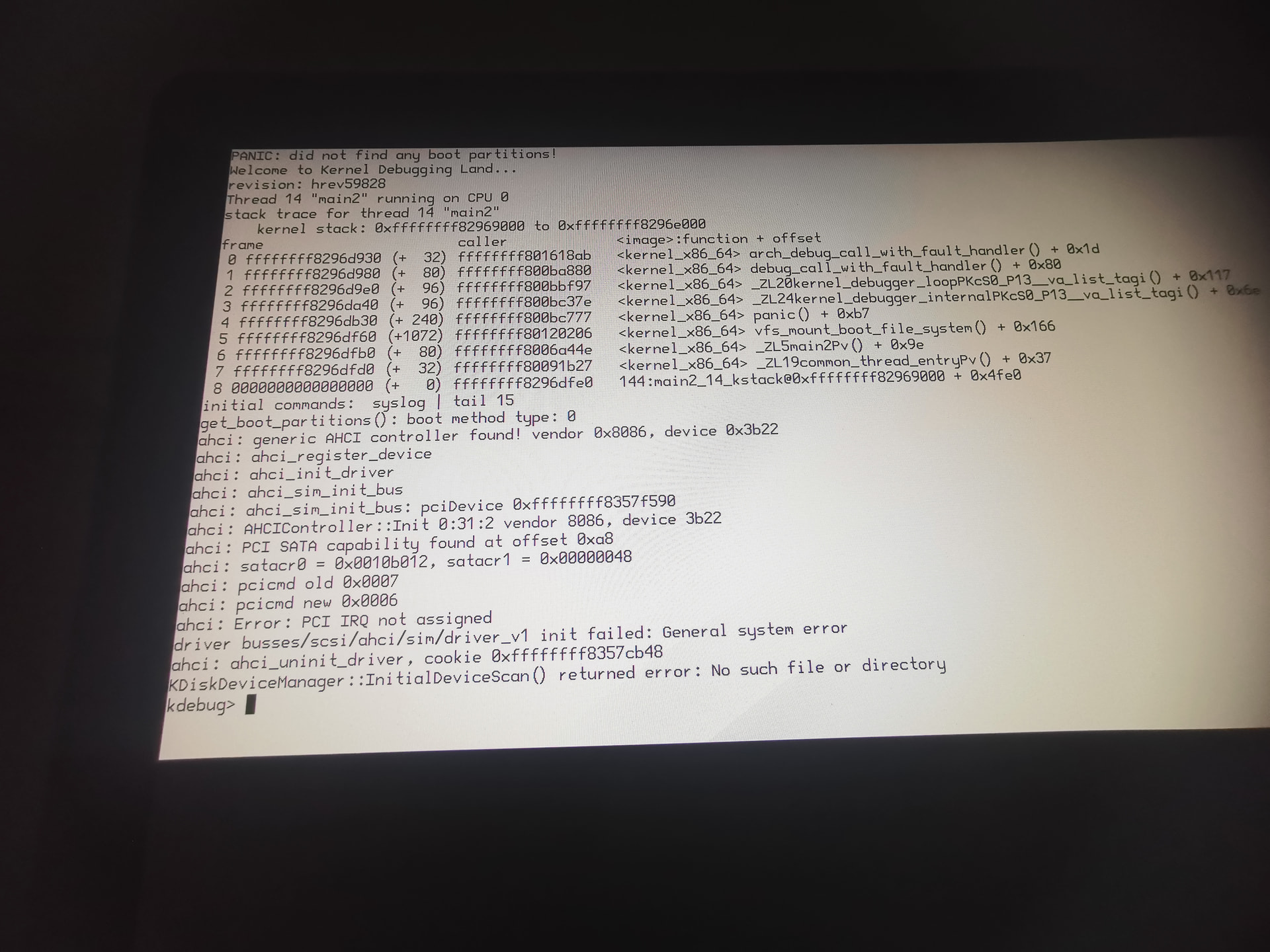

Ok, looks like you got into the debug screens, that’s great and gives a peek at possible problems. I am not a expert on the kernel or drivers but it looks like the usb controller is an issue, I have a similar issue with my 2017 MacBook Pro, from some research I did it may have to do with usb-c. Not sure if you are using usb-c, maybe someone else on here can assist you and me as well.
