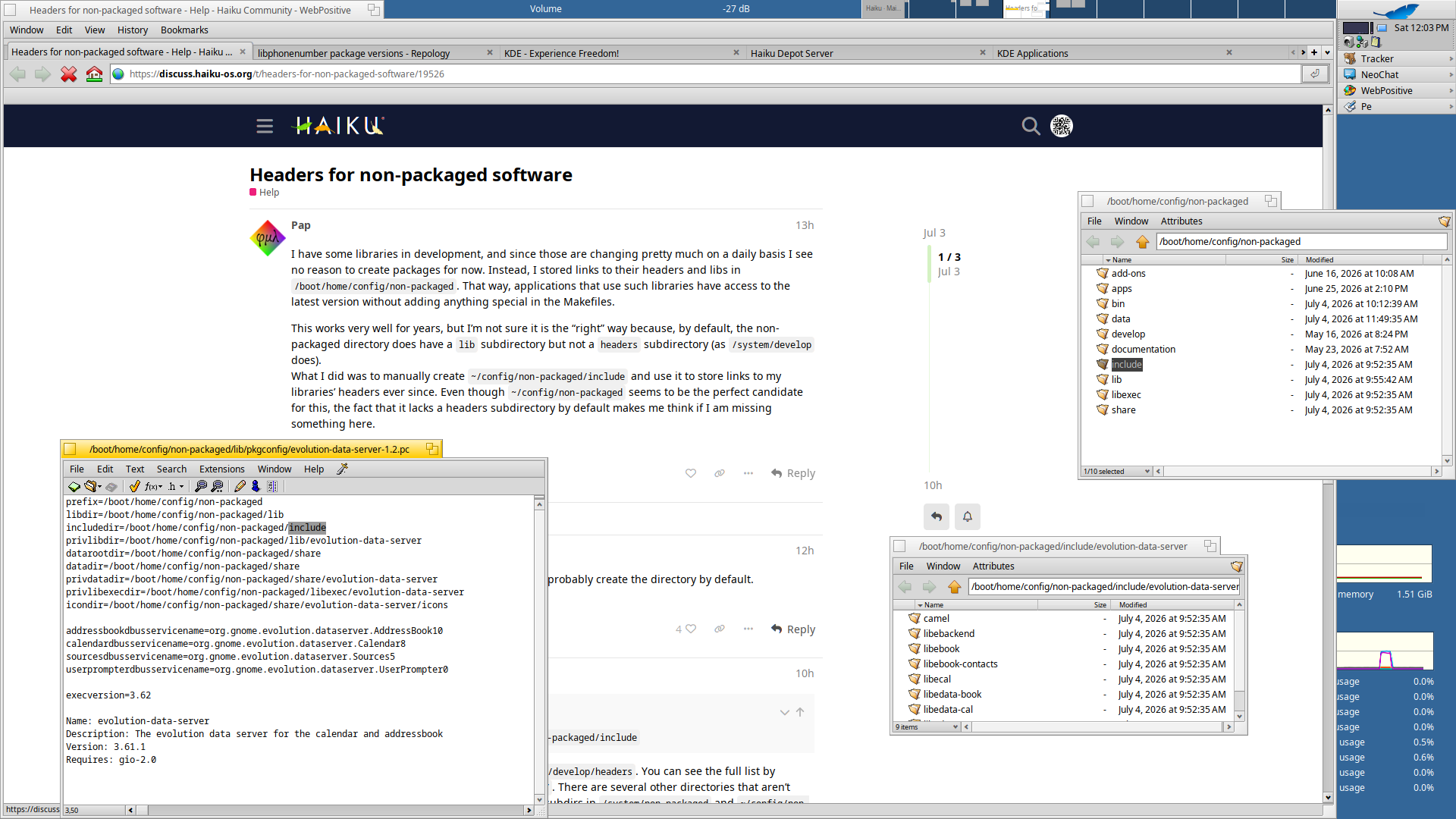

I have some libraries in development, and since those are changing pretty much on a daily basis I see no reason to create packages for now. Instead, I stored links to their headers and libs in /boot/home/config/non-packaged. That way, applications that use such libraries have access to the latest version without adding anything special in the Makefiles.
This works very well for years, but I’m not sure it is the “right” way because, by default, the non-packaged directory does have a lib subdirectory but not a headers subdirectory (as /system/develop does).
What I did was to manually create ~/config/non-packaged/include and use it to store links to my libraries’ headers ever since. Even though ~/config/non-packaged seems to be the perfect candidate for this, the fact that it lacks a headers subdirectory by default makes me think if I am missing something here.

Most build systems are adjusted to “fix” those “include” directories when the prefix is set to ~/config/non-packaged, some however use hardcoded paths and will use the above:
What you could do is try an export for PKGCONFIG_PATH:
export PKG_CONFIG_PATH+=/boot/home/config/non-packaged/lib/pkgconfig/
