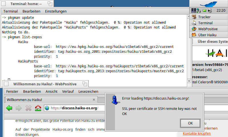

But the EeePC faces an big issue: can’t install or update software (LAN or WLAN)!
Pinging google.com works, but WebPositive fails to connect with error message “SSL peer certificate or SSH remote key was not OK
There is also an annoying boot problem: after the 3rd icon it takes ~3 minutes to continue!
~> pkgman update
Aktualisierung der Paketquelle “Haiku” fehlgeschlagen.  0 %: Operation not allowed
Aktualisierung der Paketquelle “HaikuPorts” fehlgeschlagen.  0 %: Operation not allowed
Nothing to do.
~> pkgman list-repos
Haiku
base-url:  https://eu.hpkg.haiku-os.org/haiku/r1beta6/x86_gcc2/current
identifier: tag:haiku-os.org,2001:repositories/haiku/r1beta6/x86_gcc2
priority:  1
base-url:  https://eu.hpkg.haiku-os.org/haikuports/r1beta6/x86_gcc2/current
identifier: tag:haikuports.org,2013:repositories/haikuports/master/x86_gcc2
priority:  1

If You have another PC and can download things from Haiku Depot Server web site, you could try to update openssl3 package manually. It’s just a guess…
Please check the time and date first.
Thanks @Starcrasher and @korli !
Found two versions. Installed openssl3-3.5.8-1-x86_gcc2.hpkg (4275708 byte), rebooted but nothing changed. Then with openssl3_x86-3.5.8-1-x86_gcc2.hpkg (2273066 byte) the same result.
~> openssl version
OpenSSL 3.5.8 25 Aug 2026 (Library: OpenSSL 3.5.8 25 Aug 2026)
~> pkgman update
Nothing to do.
Did I miss something like generating new keys?
Did you check the system date and time?
Sorry @korli , I thought you wrote about the date of the new openssl package.
You are right, the system date was off!
Thank you, updates and WebPositive are working now :+1:
