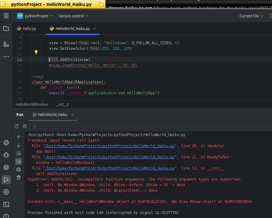

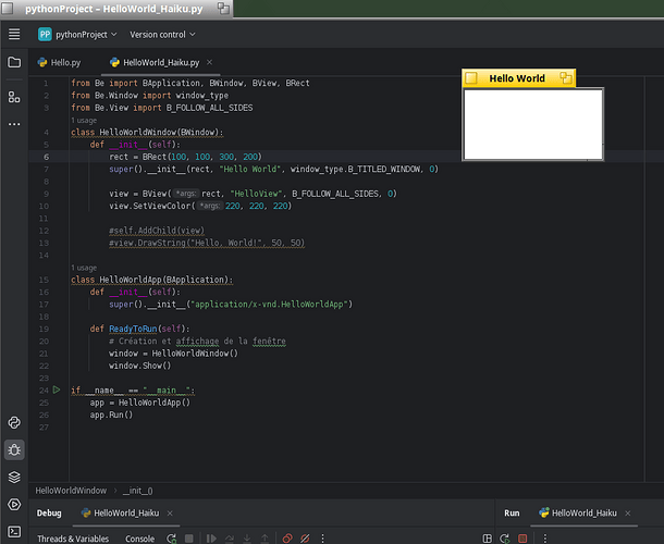

Hello,
I’m investigating if PyCharm + python + PyAPI is easy to use.
For the moment, I’ve got a quick example working in PyCharm : however is there any documentation regarding how to use the PyAPI ?
Trying to add the view to the window, I’ve got the below error :
The documentation is mainly the C++ docs and code that has been written with it. For your particular problem, that should be self.AddChild(view, None). I have just added more links to example projects in the Haiku-PyAPI README.

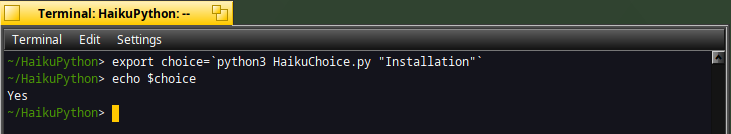

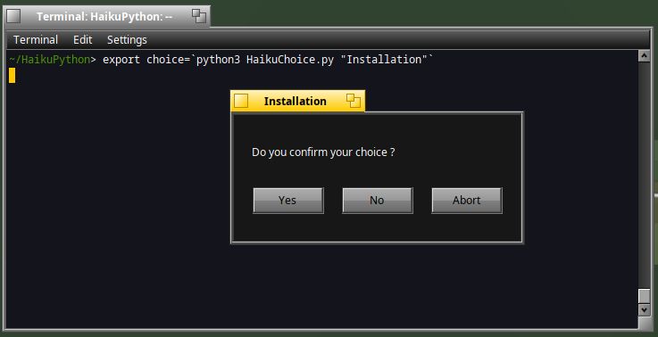

Example of usage of Python+HaikuAPI with bash interaction :slight_smile:
That does seem to be duplicating the functionality of alert:wink:
Yes this is to showcase what can be done using just Python with the API.
