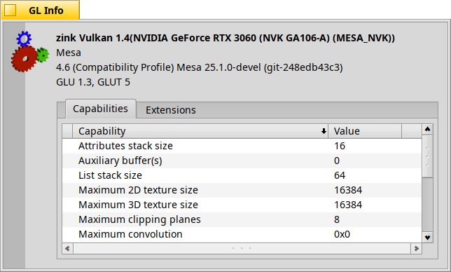

I saw 3Deyes used the Nvidia GTX 3060 with Zink driver of Mesa 25.1.0:
