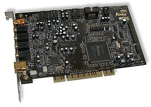

Has anyone posted the Haiku drivers compiled for any stable version of BeOS? Specifically, I’m looking for an Audigy driver that will work on my system (card ID is 0x7).

Have you tried Haiku to see if sound works for you?
Looking at Haiku emuxki driver code:
#define CREATIVELABS_VENDOR_ID 0x1102 /* Creative Labs /
#define CREATIVELABS_SBLIVE_DEVICE_ID 0x0002 / Creative Labs SoundBlaster Live /
#define CREATIVELABS_AUDIGY_DEVICE_ID 0x0004 / Creative Labs Audigy and Audigy 2 */
The SB cards supported are those with IDs 0002 & 0004. Your Audigy (LS?) Card ID: 0x0007 is NOT supported.
You can check here:
http://pci-ids.ucw.cz/iii/?i=1102
Click 0002 & 0004 to see what SB cards are supported ( list is not complete ). I believe most Audigy1 cards work except for the Audigy1 LS.

I don’t think it’ll work for you. Read on.
Depends on your sound card chipset.
If it had emu10k1 or emu10k2 chipset then swapping in your card id may work in getting the BeOS driver to work for you. emuxki driver is supposed to support these 2 chipsets only.
How to tell the chipset on your card? Pull it & look at the biggest chips on it. Or if you run Linux you can check to see what driver it uses.
Here is a list of Creative cards, chipsets & drivers.
http://www.alsa-project.org/alsa-doc/index.php?vendor=vendor-Creative_Labs
The Audigy LS is actually listed as “Sound Blaster LS” ( check the URL on the link there ). The chipset listed is SB0310. Driver for it is ca0106 ( not emu10k1 ). If chipset info is right then you’re out of luck and need to either wait for someone to port the ca0106 driver - not likely to happen soon or better choice is to buy a supported Creative card.

Yes Creative has done this on a couple of their lower end sound cards. I too noticed this about 1 year ago.
I’d suggest getting rid of that Audigy LS card. It is software based and not that good.
Read Audigy SE & LS
Even a SB Live card, which I can buy locally for $10 used from computer reseller, is better than the Audigy LS or Audigy SE. ( Emu10k chips were the best - great sound; X-FI uses EMU20K1 more advanced better chip ).
Or you can try to find used Audigy1 or Audigy2 with Emu10k2 chip ( SB Live uses Emu10k1 ).
