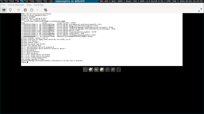

I tried running the Haiku nightly image on a VM, and after launching it, I got the attached screen. I just wanted to confirm whether this is the expected result or if something might be wrong :
From the logs it seems like it cannot find disk partition to boot, have you created and specified that partition before starting VM?
Virtio disc is not supported any longer, it was buggy. Make sure that you’re using virtio-scsi or another.

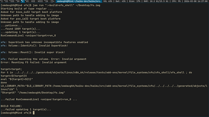

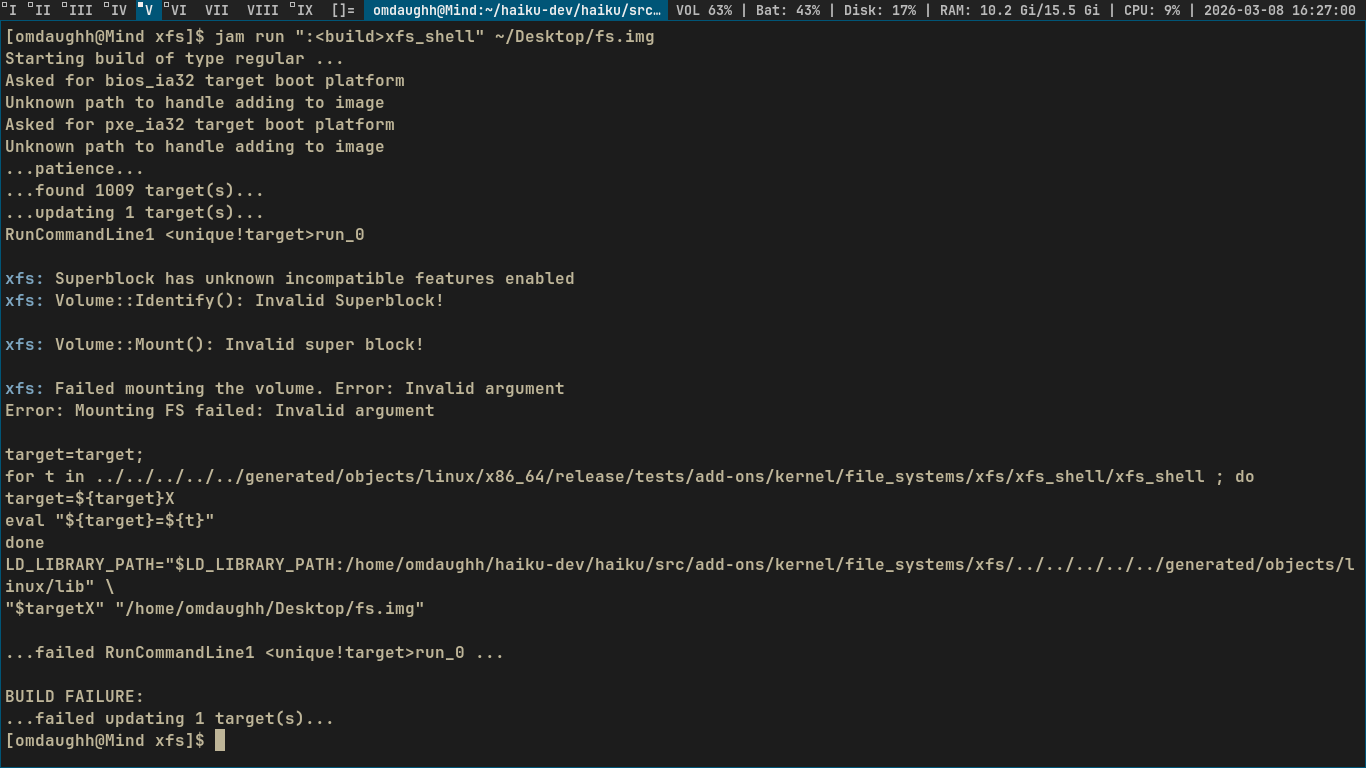

Hello @PulkoMandy ,
I was building xfs_shell and encountered an error. I tried several times to fix it, but unfortunately I couldn’t find a solution.
I moved the fs.img file from its original location and ran the command jam run "<build>xfs_shell" fs.img. I still received errors, even though I also tried specifying the full path to fs.img in the command.
If you have any suggestions or guidance on what I should try next, I would really appreciate it.

The first error message is “Superblock has unknown incompatible features enabled”. I don’t know how you created and formatted your fs,img, but if the error is correct, this could be caused by it using a newer version of XFS with some features that we don’t handle yet. Maybe you can look at the code that reads the superblock and see if you can improve the logging to print which feature bits are being set that we don’t understand, and investigate if Linux XFS developers made some changes there and introduced new features that we need to support.
Or maybe the error message is not right, and comes from some other underlying error (since afterwards it complains about an invalid superblock). So you may want to check that as well. Do we identify the superblock first and then check feature flags? Does the error come after reading some things from the image, or does finding fs.img fail altogether? (in which case it should probably fail with a different error message, and you can work on fixing that).

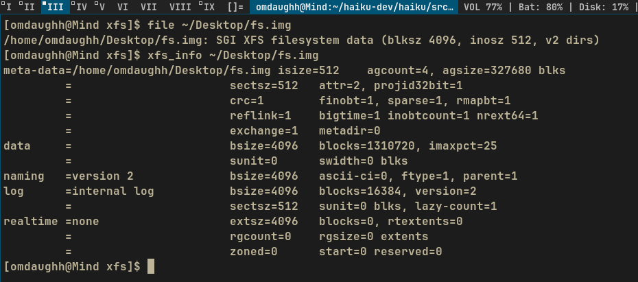

Before building/running xfs_shell over fs.img, did you first format this image file to XFS format using the Linux driver? The invalid superblock error suggests the image might not be properly formatted as an XFS filesystem. Can you confirm you ran something like mkfs.xfs fs.img in a Linux environment before attempting to mount it with xfs_shell?
You can use file fs.img to verify the fs of image or xfs_info fs.img to verify xfs superblock

Hello,
Yes, I formatted the image using mkfs.xfs fs.img in Linux before running xfs_shell. I also verified it using file fs.img and xfs_info fs.img, and both indicate that the image is formatted as XFS.
Here is the screenshot for the outputs

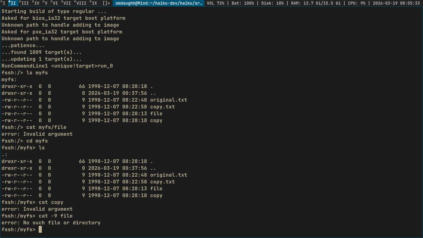

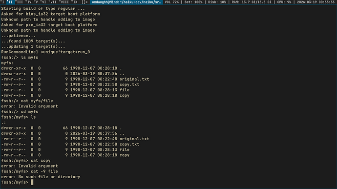

Hello everyone,
I’ve been working on the following TODO:
https://grok.nikisoft.one/opengrok/xref/haiku/src/add-ons/kernel/file_systems/xfs/Inode.cpp?r=afaeb2d45de94655cd9509d0dc3c975a98584b36#277
I’m almost done with the implementation. The code compiles without errors, and everything looked fine initially. However, when I started testing to ensure everything behaves as expected before submitting, I encountered an issue with the files.
Could this be related to the current read support in the filesystem, or is it more likely that I made a mistake in my implementation?
Any insights or guidance would be greatly appreciated
