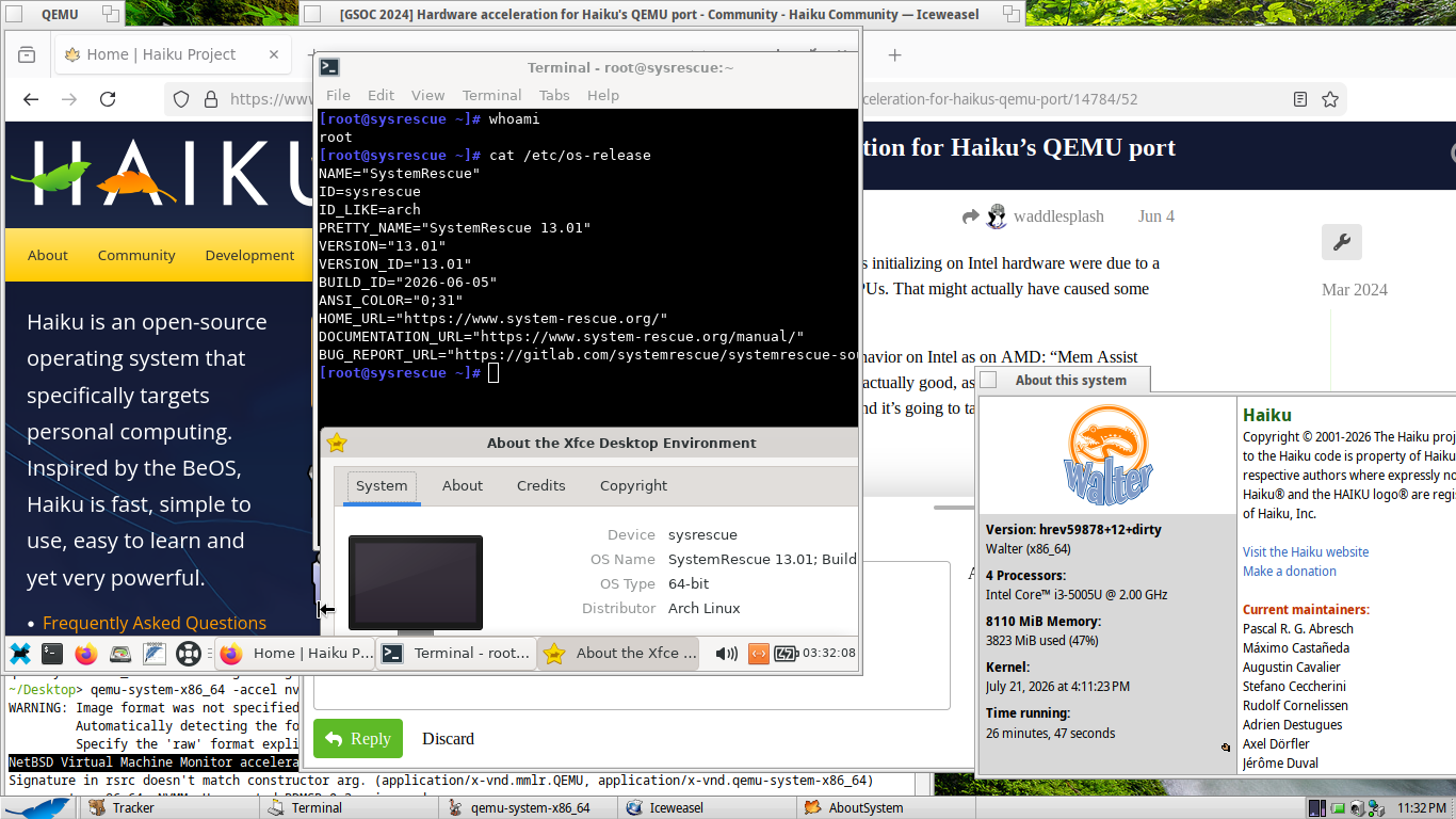

Kudos to @sed4906 for uncovering the last remaining bug that was keeping Haiku guests from reaching the desktop. It turns out that Linux guests didn’t need the fix Haiku guests did; at some point in the past month the crashes that were preventing them from getting to the desktop got fixed (probably in the changes I made to FPU state management in the NVMM-Haiku glue code.)
Haiku guests need to enable the “Don’t call the BIOS” option for the moment, which means you’re stuck with whatever VESA resolution the bootloader picked. Not sure yet if this is a Haiku or a NVMM problem; there’s a behavior difference in QEMU between the two, and the cause isn’t sorted out yet (Linux can change resolutions just fine.) We’ll figure that out in time, I’m sure.
Meanwhile, SMP even works (the Linux VM in the screenshot is running with 2 cores)!
I’ve gone ahead and enabled NVMM in master and the beta6 branch already. However it’s going to take a few days to get QEMU builds with NVMM enabled in the depot; we’re in the middle of some rebuilds at HaikuPorts and the QEMU build looks broken at the moment. So for those of you who absolutely can’t wait … here’s a package. Just add -accel nvmm and look for the NetBSD Virtual Machine Monitor accelerator is operational print at QEMU startup.
