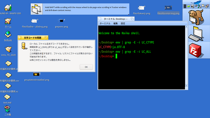

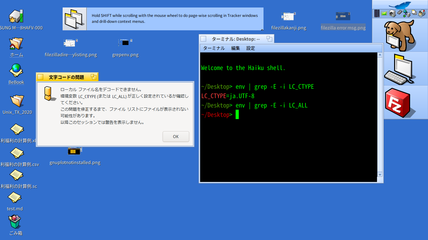

When I start up Filezilla in Haiku hrev57937+129, I get an error message like this
“Character encoding issue: A local filename could not be decoded. Please make sure the LC_CTYPE (or LC_ALL) environment variable is set properly. Unless you fix this problem, files might be missing in the file listings. No further warning will be displayed this session. OK. ”.
(in English)
I checked the LC_CTYPE environment variable and it’s set to “ja.UTF-8” which seems ok. The LC_ALL does not return any value.

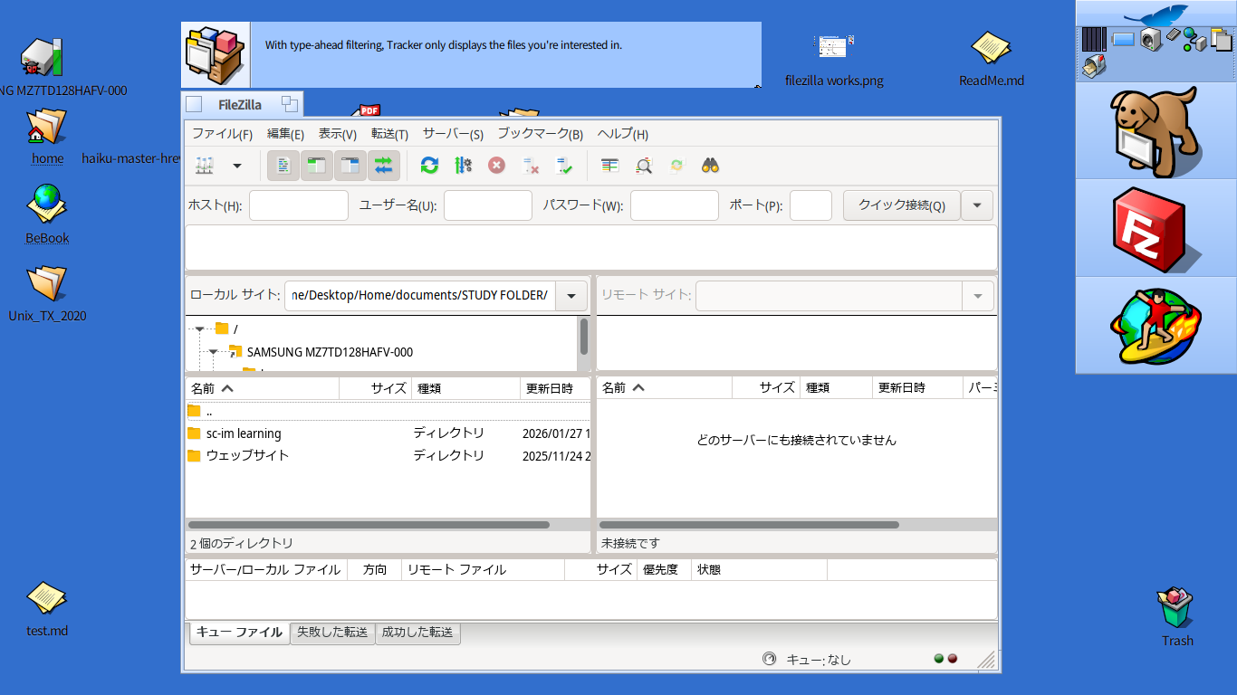

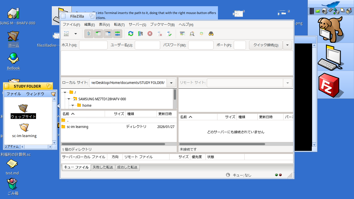

Then I click “OK” and continue to boot up Filezilla and in fact the directory listing does ignore the files and directories with Japanese character sets in their file names (such as with the folder “ウェッブサイト” in the directory listing below).

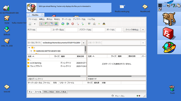

Thanks! Upgrading to the latest nightly was super smooth!
Updating to the Nightly fixed the issue with Japanese characters that Filezilla was having. Thanks for the support as always!
