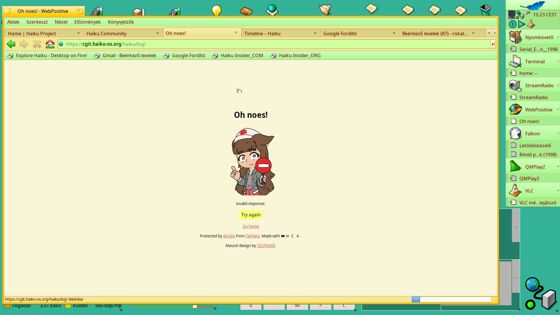

I got after I wanted to get back a cgit page from a link from History in Web+
Finally it had turned out … it is because
cc: @kallisti5
WebPositive, you old cookie monster… :japanese_ogre:

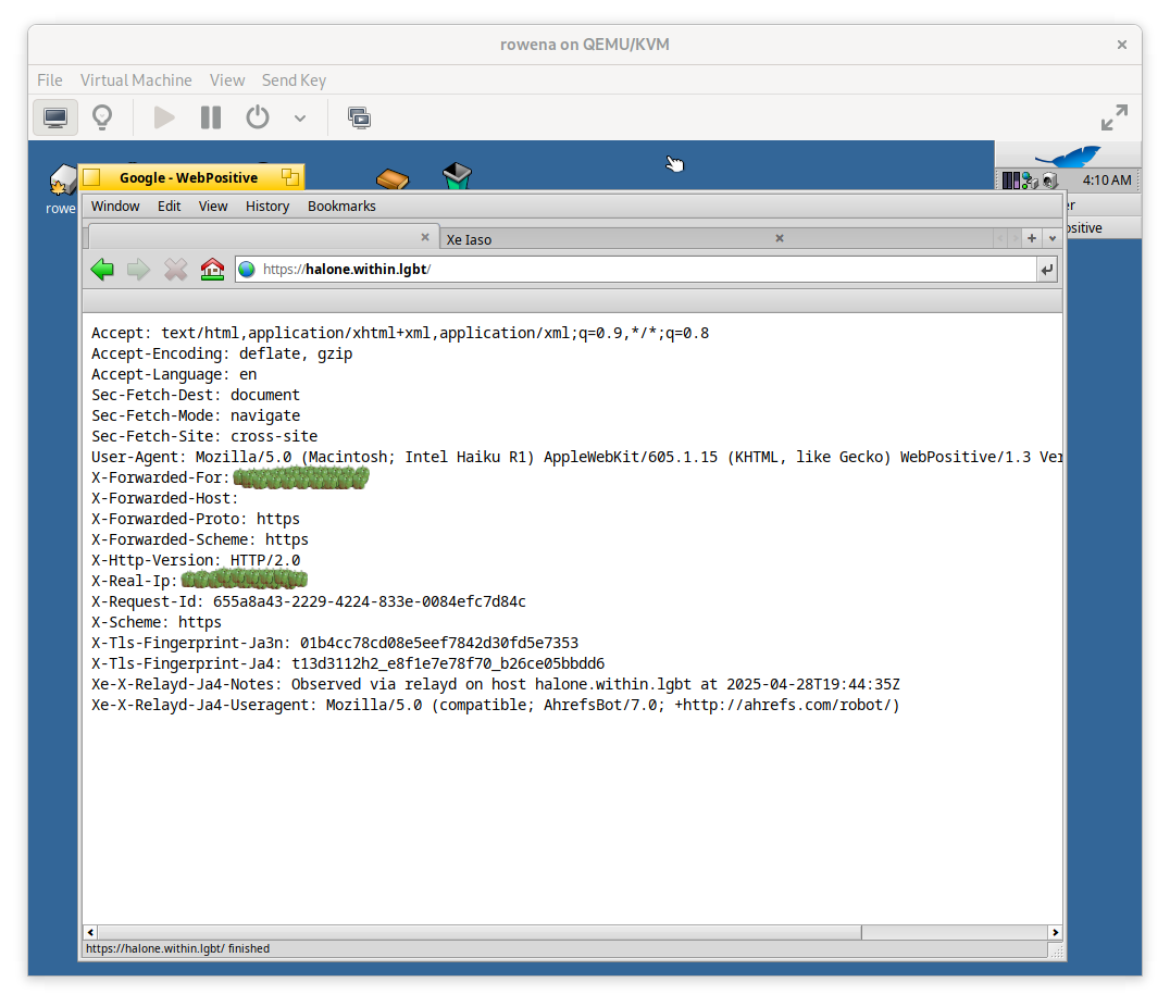

Can you connect to https://halone.within.lgbt and give me the X-Tls-Fingerprint-Ja4 header value? I’ll add WebPositive to my “known good” list.
Thanks!
UPDATE: I got a VM working and confirmed that the latest patch I’m working on for Anubis will let WebPositive through without having to “known good” its TLS signature:
