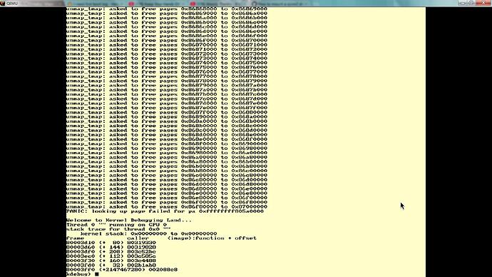

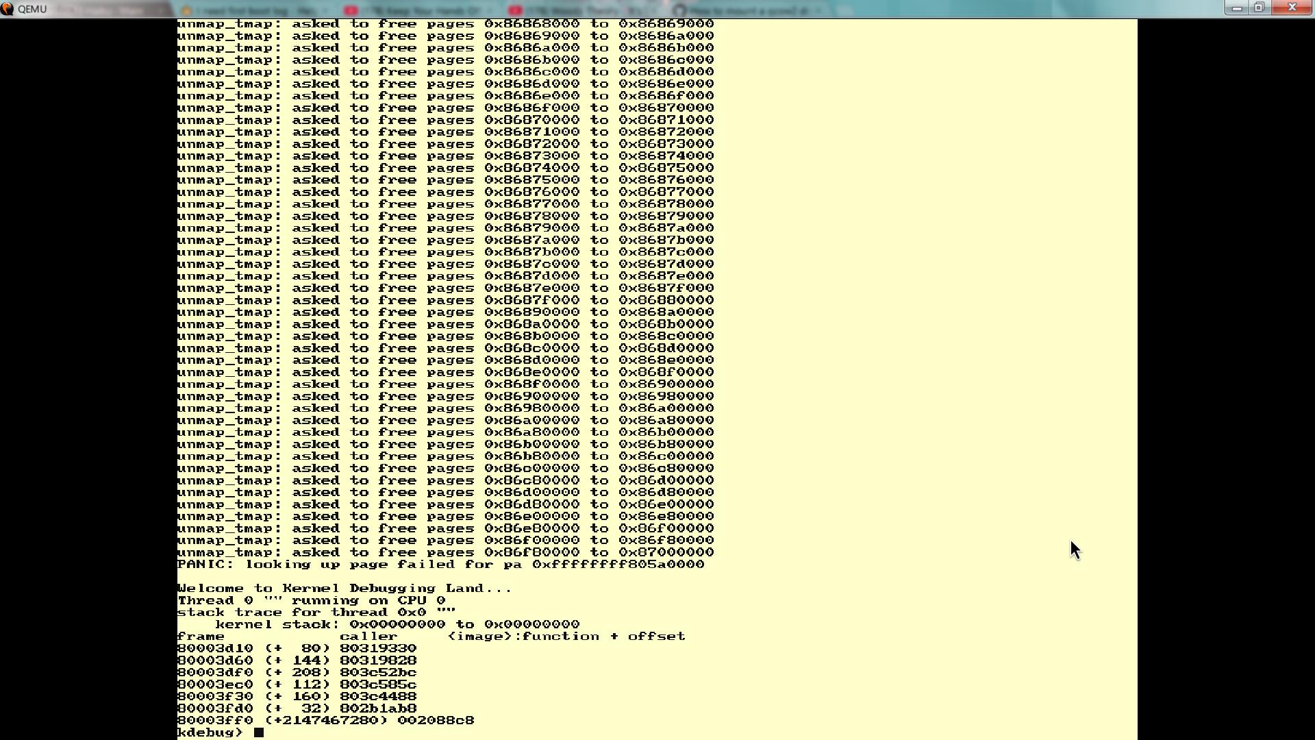

I was able to bootstrap haiku for PowerPC and boot it on qemu, unfortunately it’s failing at allocate_kernel_args
You might try to debug with gdb, given how early in the kernel it is.
I’m having a bit of trouble figuring out how to be honest, I have gdb attaching to qemu but haven’t been able to get bt to show function names
