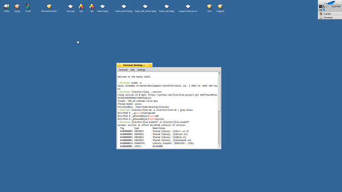

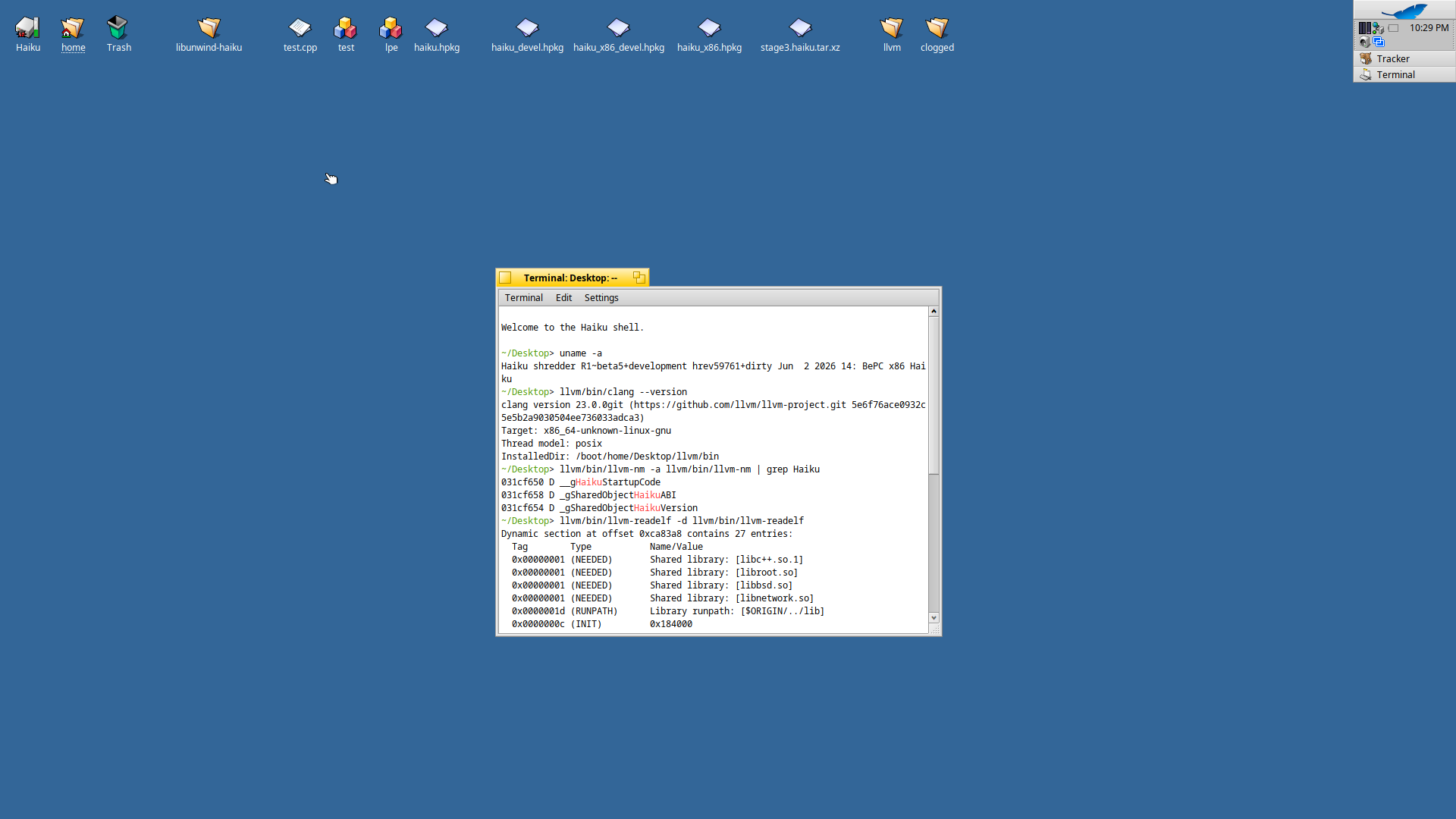

We now have a working toolchain on Haiku x86_gcc2.
You can download the binaries here: Build LLVM GCC2 · trungnt2910/llvm-gcc2@5b18634, or run the scripts from that repo to build the toolchain from source.
