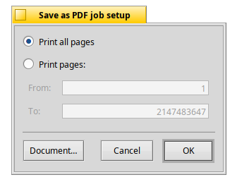

By the way, why does the “To” field in the Job setup window show such a high value (placeholder?) by default?

Regarding the default max page value, yeah, that’s bad UX indeed.
It shows it was made in the early years of BeOS/OpenBeOS, when we were already happy that such feature could exists, whatever the user interface flaws it has.
Should be empty by default, I guess, except if at this stage the PrintJob has already the total pages value available, which I don’t think it has yet.

Yes, empty by default should fine. Or it could be a single field with a “1 - 10” placeholder that disappears when clicking on the field. I am not a UI expert, though… :sweat_smile:

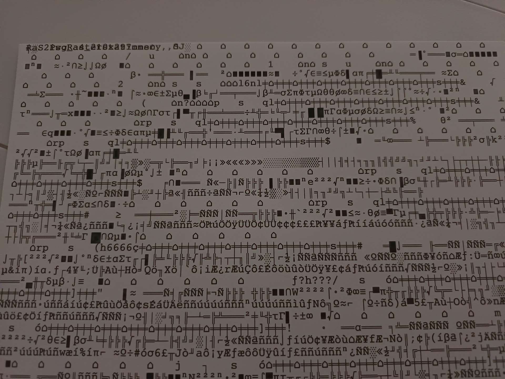

Ok, did the test in USB mode:
  • Enable USB interface on the printer
  • On Haiku, create a printer queue, select USB transport (the printer name shows up as expected in the list of USB transport available ports), and IPP Everywhere driver) .
  • Print a Test Page
Alas, turns out my printer doesn’t support IPP over USB, only over network. In fact, when you enable USB connection, the firmware actually reboot (you can’t have both at the same time), in USB mode it expect classic and Epson native ESC/P print data.
So let me told you that when I saw on the first page “RaS2PwgRaster” printed followed by a lot of garbage text, I cancel it quickly :slight_smile:
So, I guess you’ll have to find someone owning a printer which does support IPP over USB for that test.
Hi @phoudoin
Thank you for testing, and sorry for the wasted paper and ink :disappointed_face:
That happened because you chose USB as the transport. For the driver to work over IPP-USB, you have to choose IPP (fixed) as the transport, not USB. (I thought it was mentioned in the README, but I have to admit it is confusing).
I will add a check to avoid this from happening, and will change the transport name to IPP (network/USB) to make it clearer to the user what transport they need to choose.

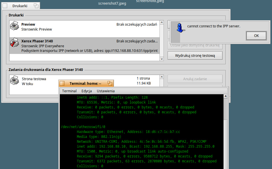

Test done. Not sure if I did it correctly. Look at the printer URL. Is it ok. I used my own IP.
May I suggest to follow the recommandation of IPP Everywhere here:
in case both PWG-Raster and URF is supported, the client should select PWG-Raster, and fallbackto URF only if the PWG-Raster print job is rejected by the printer.
PWG-Raster is more featured. And an open standard, while URF was reverse engineered (and some fields in the pages header are still not documented by Apple…).
I’m full to support both, but let’s select by default the open standard one. Printers supporting only URF are very rare, anyway.
The Xerox Phaser 3140, AFAICT, has only USB connectivy. And is not IPP Everywhere compatible. It supports only a specific SPL language it seems.
We don’t have printing driver for this specific language.
CUPS and Ghostscript app, available on HaikuDepot, seems to have, via a “sDEVICE=splix” filter seems to be able to generate a print “file”, but from there you will no way to send to the printer anyway.
