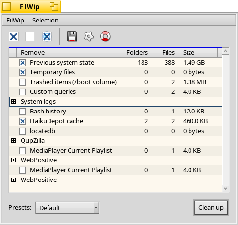

If you go the BColumnListView way, you can take inspiration from FilWip source code, CheckBoxWithStringColumn.cpp/.h :
In FilWip, BColumnListView is used in a 2 depth tree view, but you can perfectly use it without any hierarchy.
If you go the custom BListItem/BStringItem, at least you can see in CheckBoxWithStringColumn.cpp how BControlLook is used to draw the checkbox in order to have the system look instead of doing it all by yourself.

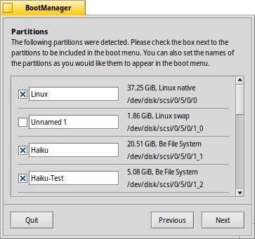

Or you can use BGroupView and just add the BCheckBoxes and BStringViews. BootManager does that in its partitions page.
Depending on the volume of items, indeed just building via BGroupView into a view, itself set into a BScrollView, could be a better, easier way, as done in bootmanager.
@zittergie here how bootmanager Partitions “selectable” list looks currently (keep in mind the look is directly due to the choice of using a view with background panel color and to layout the different info that way, but other choices are possibles:
Having just grid with multiple checkbox without label + string view (or even just a checkbox with info in its label) in a white background view built via a BLayoutBuilder::Grid<>, this view itself withing a BScrollView, will produce also what you may be looking for.
It mostly depends on the volume of items you expect to in that list and if you want/make sense to allow user to sort or swap “columns” of info, or just presenting him a list of limited number of items with a checkbox.

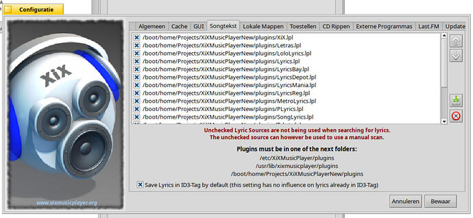

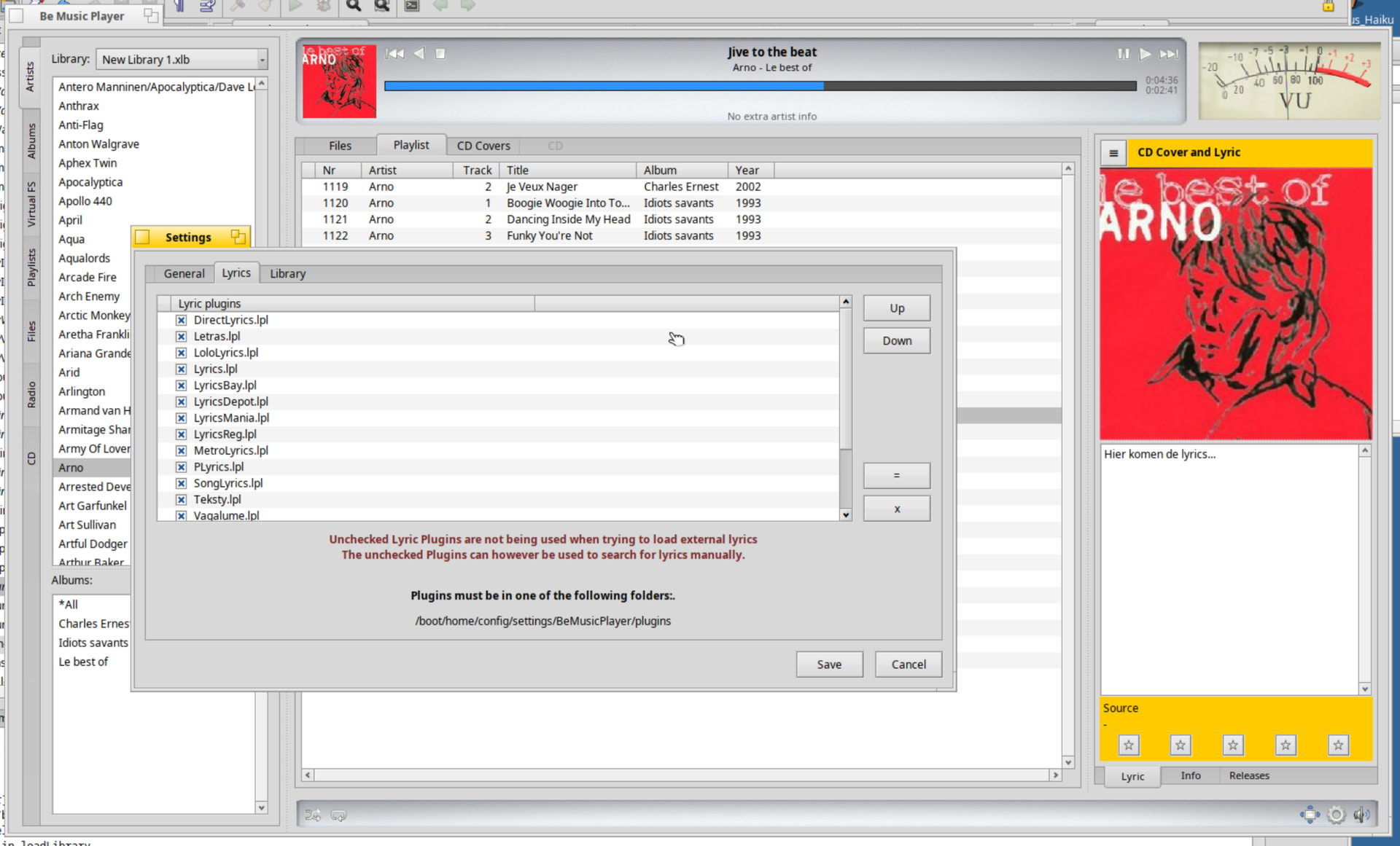

I have used CheckBoxWithStringColumn.cpp from FilWip:
