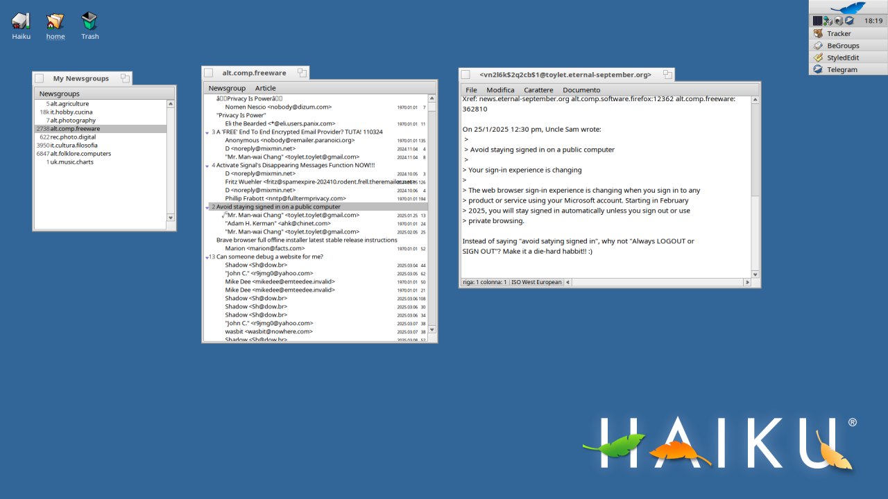

BeGroups: A native Usenet newsreader (think Reddit, but as open standard)
