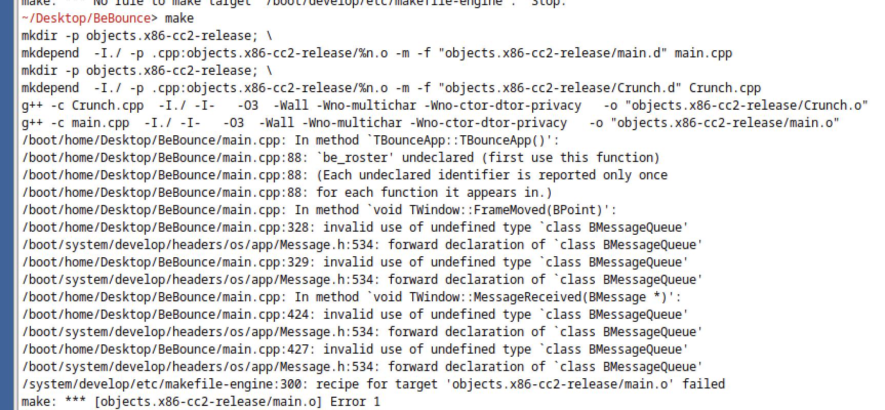

OK, what I have done:
  1. Downloaded → http://mirror.pulkomandy.tk/unsorted/ftp.beos.hu/ftp.beos.hu/pub/beos/development/samples/application_kit/BeBounce.zip
  2. Extracted & adjusted in the make file the line with the include
    from →
    include /boot/develop/etc/makefile-engine
    to →
    include /system/develop/etc/makefile-engine
  3. Executed make →
    Which responds with:

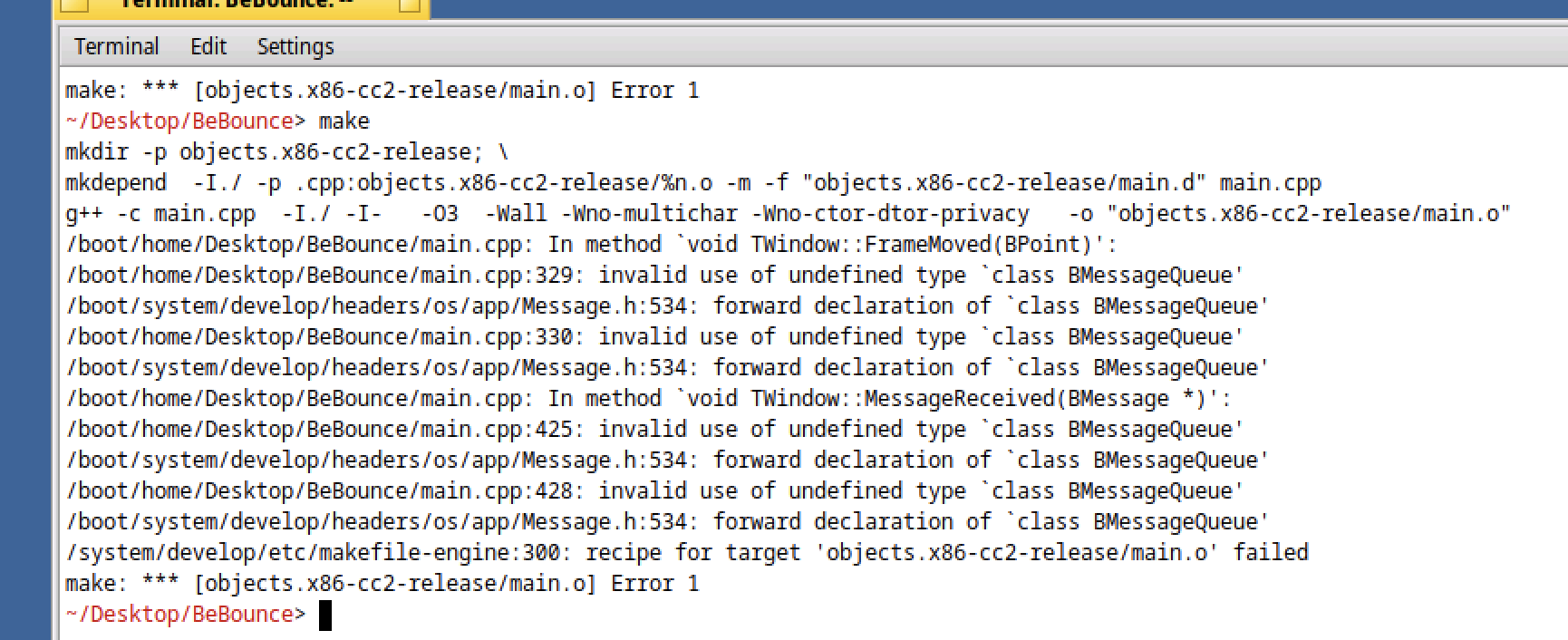

#include <Roster.h>
(Haiku is binary, but not source compatible with BeOS so a few minor adjustments are normal.)
Thx. the undeclared be_roster problem is solved, but the remaining problems are still there :frowning:
You can check the api docs for the references you need.
In this case: The Haiku Book: MessageQueue.h File Reference
So
#include <MessageQueue.h>
Ah, very good. Thank you very much. The App is builded and it can be started.
Unfortunately only once and not twice. But definitely a good starting point for further research from me.

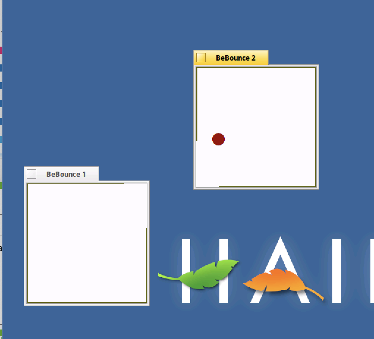

You need to have the B_MULTIPLE_LAUNCH flag set on the application resources to launch multiple instance. You can add the flag by editing the binary you generated in the FileTypes app, but I assume that it must be set in the BeBounce.rsrc file included in the zip so you should be able to set that flag by including the resource file in your Makefile:
RSRCS= BeBounce.rsrc
Thanks for the great support in the round. The flag was now the last missing adjustment.
