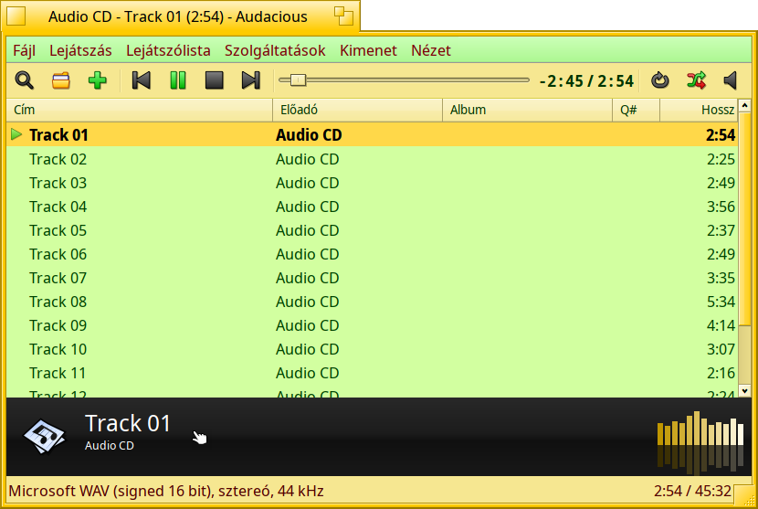

Well, finally I found the menu and settings last time, so I could do a test with it.
You are right it scales well this way !..
However direct CD play also distorted here - at least continuos, but the playing is not “joyable” :))
It is true .. it does not promise such thing primarily …
If I look at in File menu : there is no such ‘Open disc’ , so it was prepared to open music files or whole albums by directories.
I used drag ‘n’ drop the Audio CD icon from desktop - to load the tracks. It seeked the disc and added - completely - the tracks one by one to the playlist. The all tracks appeared, but for the details it added them this way.
Whrn I tried Folder icon (to open this way) then browsed the Desktop linked folder ‘Audio CD’, then the Haiku overlay showed the tracks as .wav files, and annoyingly it had not enabled to choose all at once. I thought it may work only if I select green ‘+’ icon instead of folder icon (yepp, it does this way , multi-selection then works). I just tried out this way to check out what to program does in this case. Then it showed also audio cd tracks, noit wave files, so it is the same result with D ‘n’ D … ( distortion as well :smiley: )
So, for direct CD play I am going to use SMPlayer …
